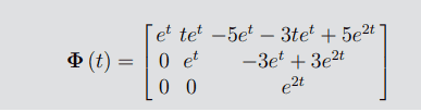

Find the transition matrix

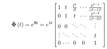

Hello! I have the following matrix (picture 1.)and I am susposed to find the transition matrix ($$ \phi $$) now for that I need the eigenvalue and vectors of this matrix A. The eigenvalues are 1,1 and 2. The eigenvectors I have found to be (1 0 0) (1 1 0) (5 3 1). Now to find the transition matrix we are given this formula(picture 2) where V is a matrix comprised of my eigenvectors and V^-1 simply the inverse. And what the middle one is the part I am having problems with. This phi wave lets call it, is susposed to be the following. In a case of where you have more than one eigenvalue that is the same ( in my case 1 is double) and where the geometrical value of those eigenvalues is 1. Phi wave is calculated like this(picture) where S is the Jordan form of the matrix and beta (this weird looking b) are the eigenvectors of the matrix. Now I dont know how to construct this,even though it might seem straight forward. What is confusing me is I know that lambda is the eigenvalue but,I have 3 where am I susposed to put the third one,what I mean by that is the lambda in the picture is I am assuming referring to the 1 (the double eigenvalue) but how what do I do with the 2? When you multiply the Jordan form with t and proceed to multiply with V and V-1 you dont get the solution. Also I have tried reading this schematic and I am pretty sure that the Matrix we need to multiply with e is simply the first 3 rows and coloumns. So basically its going to be exactly what is in this picture but the under the t should be a 1. But no matter how I multiply with e and the eigenvalue,regardless of the "combination" I cannot get to the solution.(picture 4). Thanks for the help in advance!

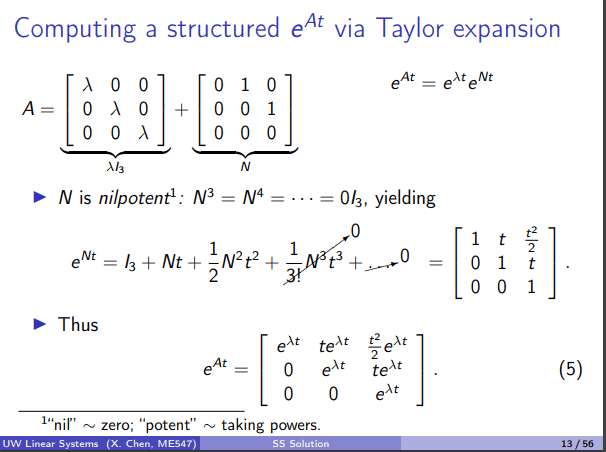

Okay I think I am slowly getting there. What you posted in your first post (#6),the very last matrix should be the Jordan Matrix (in my case that is the S). I have been able to get to find that matrix (S or as you put it that weird A) but take a look at my formula in the original post. The Phi wave should be ## e^{S*t} ## which equals the part that is confusing me. After I get my S matrix what do I need to do next?
Regarding the link you shared,I found something very interesting. Take a look at this picture;
Taking a look from the taylor expansion we can see how they derive the matrix (this is the "schematic" of how I am susposed to construct my Phi wave) and look at how their matrix looks like. Basically its the same as in my formula but the ##e^{\lambda}t## is inside the matrix itself.Now the only part that I need to figure out is what is lambda refering to? I know its the eigenvalues but which one? I have two that are the same (1) and a 2,how do I know where to put them,in what order?

Basically its the same as in my formula but the eλt is inside the matrix itself.Now the only part that I need to figure out is what is lambda refering to? I know its the eigenvalues but which one? I have two that are the same (1) and a 2,how do I know where to put them,in what order?
That example only has a single eigenvalue. The derivation is on page ten of that link, read the whole thing:

This only works for a diagonal matrix, that's why they split it into two parts.

Okay that is the case when you have multiple eigenvalues,but it is required that all the eigenvalues are different from each other (we have covered that in class). But here I have 1 as an eigenvalue coming up twice. I have tried it with that approach but it didnt work for me.
Try again. It doesn't matter if ##\lambda_1 = \lambda_2## the formula still works. Of course you have to do the off-diagonal matrix too.

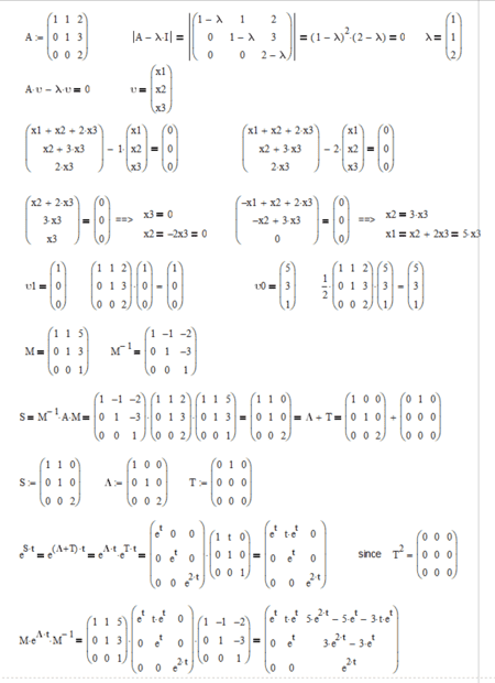

Okay I know that everyone has probably forgot about this post,but I have been able to solve this actually. The method I described above worked. Thank you everyone for the help!
Congratulations, good work!
For future readers... Here is my MathCad worksheet for this problem. Sorry, I'm just too lazy to describe it. The previous links show the method pretty well.
