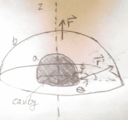

A charge distribution is given by ##\rho(r,\theta,phi)=\gamma r^3cos\theta,a<r,b,0\leq\theta\leq\pi/2## and is zero everywhere else. The distance from the origin ##r=\sqrt{x^2+y^2+z^2}## and ##\gamma## is a constant. Write out the electric field P along the z-axis a distance z from the origin as an integral over the charge density. Be sure to include all the limits of integration. Simplify the expression and carry out the ##\phi'## integration, but leave the ##r'## and ##\theta'## integrations.
##dE=kdq/r^2##
##\rho=Q/V##
##dq=\rho dV=\rho2\pi(b-r)^2dr##
So then, ##dE_z=k\frac{\gamma r^3cos\theta(b-r)^2dr}{(z-(b-r))^2}##
Is that the correct way to set up the integral? Any help is appreciated.
Not quite. You have to integrate over all three coordinates, and you want to use the volume element ##dV = r^2\sin\theta\,dr\,d\phi\,d\theta##. Also, you need to rethink what the distance between point P and the charge element is.

All right so then I got ##z-(r-a)cos\phi## as the distance from the origin and ##(r-a)^2+z^2-2a(r-a)cos\phi## as the distance from the charge element to the point P. Is this correct formulation of dq ##dq=\rho2\pi (r-a)^2R^2drd\theta \phi##? Also, I thought that by symmetry, the x and y components cancel out.
I'm not sure why ##a## is appearing in your expression for the distances. The distance between the infinitesimal charge element and point P should depend only on ##z, r, \theta,## and ##\phi## at most.

Well since there isn't charge when ##r<a##, I thought I had to subtract a from r. So with that thought I did ##r-r'=z-(r-a)cos\phi## and ##|r-r'|=(r-a)^2+z^2-2a(r-a)cos\phi## and got ##dq=\rho2\pi (r-a)^2R^2drd\theta \phi##.
Well, as vela said, we have not yet begun to consider the bounds to the region. The only important things are the coordinates. Try to do what I suggested with writing the position vector first as a function of the cartesian coordinates.

Do you mean writing ##r-r'## in terms of cartesian coordinates?
It would help a lot to understand your posts if you would stop using ##r## to mean both the vector ##\vec{r}## and the spherical coordinate ##r##.
You could also use the law of cosines to find ##\| \vec{r}-\vec{r}' \|##, or just expand it out. If you haven't already, draw a sketch with ##\vec{r}## and ##\vec{r}'##.

Sorry about that. Here's my sketch of ##\vec{r}## and ##\vec{r}'##.
So if I were to express then I can express the distance between those two vectors in cartesian coordinates as ##\vec{r}-\vec{r}'=(0-x')\hat{i}+(0-y')\hat{j}+(z-z')\hat{k}##

Precisely. Now, what is the length of that vector and what is the unit vector which is pointing in the same direction? After that it might be a good idea to express ##x', y'##, and ##z'## in spherical coordinates.
Addendum: Just one thing I noticed that I think too important to go in an edit of the post I just made. Based on your drawing, you seem to measure the angles from the inner radius of the spherical shell. The problem is not symmetric around this point and I suggest you use the centre of the half-shell for the origin also for the spherical coordinates. This may be the reason you end up with ##a##s in your expression where you should not.
How would measuring from the center remove ##a##s. Since there is no charge for ##r<a##, wouldn't there need to be something along the lines ##r-a##?

How you define your coordinates is not about where there is charge or not, it is about finding a coordinate system where your expressions simplify as much as possible. Measuring ##r'## from the centre of the cavity is going to make your integration boundaries much simpler and show the symmetry of the problem in more detail, for example the integral in ##r'## will go from ##a## to ##b## - this is where your constraints should preferably enter, not in the definition of the coordinates. In addition, I am 100% certain that these are the coordinates the problem constructor had in mind when (s)he wrote down the charge distribution. (Note that the charge distribution starts at ## r > a##, which means that there is a distance ##a## around the origin of the spherical coordinates where there should be no charge, i.e., the cavity.)

Oh Okay, that makes sense to me now. Is it right to assume that under symmetry the ##x##s and ##y##s will cancel? Leaving ##E=k\int dq\frac{(z-z')\hat{k}}{\sqrt{(z-z')^2}}##
The x and y components are going to cancel due to symmetry, this does not mean the x and y from the distance function will cancel out so you will need to keep them. I suggest you follow every step of making the change of variables if you are unsure.

Okay. So ##z'=rcos\theta## and ##x'=rsin\theta cos\phi,y'=rsin\theta\sin\phi##. Then ##x'^2+y'^2=r^2sin^2\theta## resulting in ##E=k\int\frac{dq (z−rcos\theta)\hat{k}}{\sqrt{r^2sin^2\theta+(z−rcos\theta)^2}}##
Yes, that looks more reasonable, but you are missing some powers of ##\vec r - \vec r'## in the denominator.
