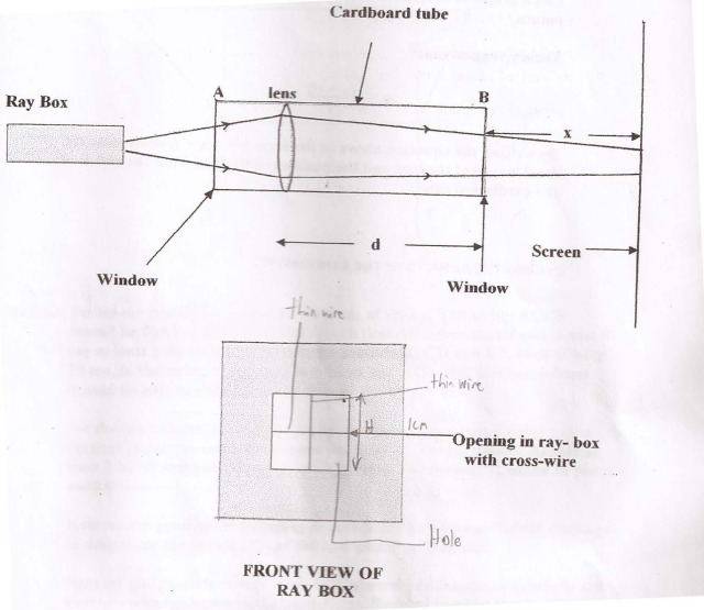

I have to find f and d
Here's the method of the lab
Method: The length of the opening in the ray box was measured and
recorded. The equipment was set up as shown in the diagram.
Hi lionely. Can you post the diagram?

I plotted a graph of m against x gradient = m/x
so gradient would = 1/f right?
then i could solve for d after?
Yes, the gradient (slope) would be 1/f. The y-intercept of your graph is related to d. So, you could use the y-intercept to find d.
I get a negative value when i try to work out d... I think something is wrong.
Nevermind I made a mistake ...
