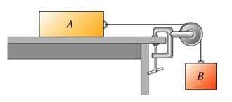

Blocks A and B have mass of Ga and Gb respectively. Wire has no mass, it starts moving so that B has constant speed downward
1.Find μ (frictionkoeficient) regarding GA og GB.
2.When system start moving a cat with weight Ga jums on block A and system stops ( falls into equilabration ) Show that acceleration is proven by this formula :
a= - (μGA / (2GA + 2GB) ) * g
heres the pic to describe prob

Start by enumerating the forces that act upon the two blocks. Ignore the cat for now.
You mean like this ?
I mean Block A: gravity, friction ... and later a cat
Block B : gravity
In order to unify them you place them in an equation:
Ffriction=Fgravity
Ffriction=μGag
Fgravity=Gbg
Have fun
ok here is how I attempt to solve the case
Take a look at the pic
step 1 regarding 3)
Since there is no mass on "wheel" F(res) = m(wheel) * a = 0*a = 0
step 2 regarding 3)
K = [tex]\sqrt{}((SxS)+(SxS)[/tex] = [tex]\sqrt{}2[/tex] * S
step 3 regarding 1)
Newtons 2. in
x direction gives S - R = Ma
y direction gives N = Mg
step 4 regarding 2)
y direction mg - S = ma
if we add S-R = Ma and mg - S = ma we end up with
(M+m)a = mg - R
since R = μ * N and N = Mg
(M+m)a = mg - ( μ * Mg)
-μ * mg - mg - Mg = a (M+m)
μ*mg = Ma + ma - Mg * mg hence
μ = (Ma + ma - Mg * mg)/ mg
whatever I try it does not leave me with Mg or/and mg alone in equation...
can someone please help me need to do this by tomorrow :(
I will not read all of the above because it is much too much...
The problem is simple ... not complicated.
B pulls A at a constant velocity which means that the friction of A is equal to the pulling force of B which is a gravitational pull.
That means that μGag=Gbg from which we get μ=Gb/Ga just as simple as that.
About the second part I don't get what acceleration it is all about but maybe some else undestands.
