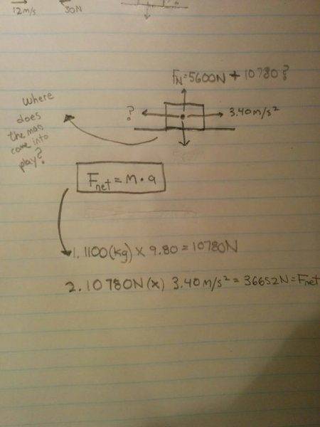

Hey new to forum here... Grade 11 physics student... Love physics and math! But this one question seems easy but I can't seem to get through... Here it is : A 1100kg car accelerates at 3.40 m/s. If the wheels exert a force of 5600N on the road, calculate the force of friction resisting the motion?
F net= m x a ... But I don't which equation to use.. I know friction is normally calculated with F fr = u * Fn [/B]
I have the answer... But don't know where to start other than maybe finding the net force.. [/B]

First, acceleration has units of m/s2, not m/s, which are the units for velocity.
Second, you should draw a free body diagram of the car. Remember, the car is accelerating, so what does that tell you about Fnet?
Well if its accelerating doesn't that mean... Its an unbalanced force? And that I can determine the Fnet... And ye .. Hahah i know that acceleration has the squared symbol... But I don't know how to put it on my computer :/

When you draft a post, the Green tool bar over the edit box contains several different buttons. The button marked x2 supplies superscripts for your text.
Looking at your free body diagram, you have shown the forces acting on the car bass ackwards. The weight of the car is not important here, only the balance between the tractive force (5600 N) and the opposing friction force, which you are supposed to calculate, given that the car is accelerating in a horizontal, rather than a vertical, direction.
You are still trying to calculate the friction force as if you knew a coefficient of friction (which you don't) by turning the tractive force into a part of the normal force (which it isn't).

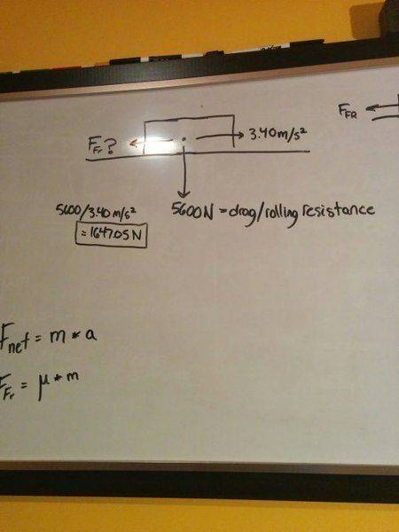

Ye.. So should it look like this than ?

No.
Forget the rolling resistance. As SteamKing noted, no vertical forces are interesting here. You just have a car of known mass and acceleration, a given propulsive horizontal force from the tyres, and an unknown (to be determined) drag force; all horizontal.
From those you can construct an equation ##\Sigma F = ma## for the horizontal direction.
