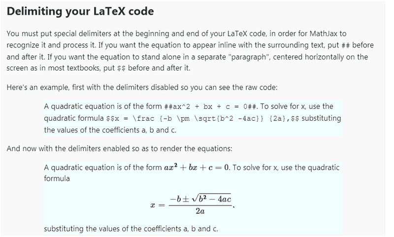

Just click on the "LaTeX Guide" link below the Edit window to learn the basics. :wink:

You know what drives me crazy about these guides?
They never ever say what the tags are to bracket latex (since that's site specific).
Is it [ latex ]? [ LATEX ]? [ tex ]? [ TEX ]? < TEX >, etc.?
This trips me up every time and is by far the most common reason why I fail to use latex. (It's different on every site, so it's not like once I figure it out I'll never forget).

Well, at least at PF it is straightforward (I agree that it seems different on different websites):
