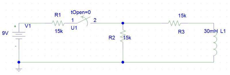

vthokie11
The switch in the circuit has been closed for a long time before opening at t = 0
a. Find i(t) across R3 for t>0.
b. Find i(t) across R2 for t>0.
I have attached the circuit.
The only thing I know for this problem is that when a switch has been in a certain state for a long time an inductor acts essentially like a wire (no resistance) and when the state changes the inductor has infinite resistance.

To solve this you need to know the formula for di/dt for RL circuits. Isn't this in your textbook or covered by lecture?

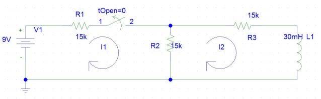

So I've done some work and this is what I've came up with...I'm not sure if this is even remotely close:
I applied KVL's around each loop
Am I even on the right track with this?
