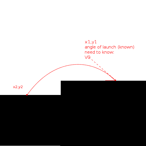

First off, this isn't Homework so there is no question per se. I'm having deriving something that probably was in my Physics I/II course, but I forgot.
Here's my problem... I have two cannons (points) in 2D space, I'm not using vectors, just separate scalars for both the x and y coordinates I have a constant angle (generated randomly) and what i want to try to find are the x and y velocities. I need no time dependency in the formulas.
so far i think i have the y velocity but I'm not sure, and I'm at a loss to get the x velocity:
from the formula: v^2=V0^2+2g(r-r0), I was able to get v0=sqrt(2g(r-r0)-v).
but I don't want any dependence on v or time, so I'm slightly stuck.
(I'm trying to write AI for a 2D cannon computer game)

I assume that you want 1 cannon to shoot at the other cannon. There are actually an infinite number of (x,y) velocity pairs. If you have a very small x velocity, then you would need a very large y velocity to reach the cannon and vice versa.
Well, as for inputs there will be the difference in x coordinates and the difference in y, I will have it generate a random angle for the cannon to fire at (between 0-90 of course)
and all I want to find is the required velocities for hitting the target. there will be terrain, but I already have it destroyable, so getting around it isn't the problem.

good to know, solving for v0 would be exactly what i need, but they are likely to be at different heights, so what if they have different heights? that is what is really stumping me. i do have the height of each.

not quite,
this sums it up (hopefully my poor drawing abilities get the point across):
I understand. It's getting late where I am. I will come up with an answer in a few hours.
When the firing cannon is higher than the other one, the angle is given by
[tex]tan\theta=\frac{v^{2}\pm \sqrt{v^{4}-g(gR^{2}-2v^{2}h)}}{gR}[/tex]

I'm having some trouble implementing this, i keep getting NaN (aka, i). I understand that for some angles there is no velocity that will suffice, but when i don't get NaN the velocity is not enough to reach the other cannon.

neededPow should be the velocity, later i do a check for NaN, but this isn't giving correct results, do you guys see anything wrong with it?
