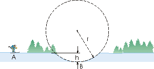

A 69.2-kg skier encounters a dip in the snow's surface that has a circular cross section with radius of curvature of r = 13.2 m. If the skier's speed at point A in the figure below is 8.13 m/s, what is the normal force exerted by the snow on the skier at point B?

As shown, h = 1.63 m. Ignore frictional forces.
ok so we are given:
mass=69.2kg
radius=13.2m
Velocity1=8.13 m/s
Change in Y=1.63m
gravity=9.81m/s^2
we know KE1 + PE1=KE2 + PE2
with potential energy2= O
ok so first thing I did was try and find velocity2 with the formula
so 1/2*m*v1^2 + 0= 1/2*m*V2^2 + m*g*Y
so V2=sqrt(V1^2 - 2*G*Y)
I got V2=5.84092
Then I did sum of Forces Y=(normal force - m*g)= mass * Arad
Arad= V2^2/R
so normal force=(mass*(V2^2/R))+m*g
so normal force = 709.473 N

I can't see the diagram without a username and password. Is B lower than A, or higher? Is v1 the speed at A, or B? Make sure everything is consistent.

A is original heigth, B is the bottom of the circle, below A.
V1= Velocity at A
picture was attached.
  • Diagram of a skier at point A on a flat surface on the left, a dashed circular loop of radius r with a radius line drawn to its lower right, and point B at the bottom of the loop with a height h marked between them.

Is v1 the speed at A, or B? Is Y the y coordinate at A, or B? Your method is correct, but you have a sign issue. (One way to see that you made a mistake is to note that V2 is smaller than the initial speed, which doesn't make sense.)
v1 is speed at A, Y is the height at B to the level of A. can you tell me where I made a mistake on my signs?
If your height at A is 0, your height at B should be negative, not positive.
