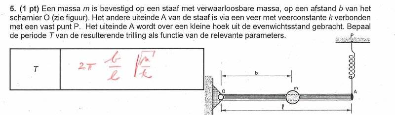

Find the period of this SHM, the mass of the rod is negligible, the mass of the sphere isn't.
None
https://ibb.co/QYk8wnD
These are my notes, i already watched some yt videos but i dont seem to find the answer.

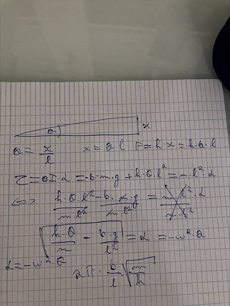

Can you describe in words what you are trying to do in your notes? How would you find the oscillation period if the system were simpler, like a single mass hanging from the ceiling by a spring?
(I will also send you a message with some tips for how to post math equations at PF using LaTeX).
Remember that you are interested in oscillation about equilibrium. At equilibrium the spring is not relaxed. When you take that into account you should find that g is irrelevant.

Normally i would just use T=2*Pi/omega.

First i wrote down the forces while at equilibrium, then i wrote down what would happen if the rod would get an acceleration.\[T = 2\pi \sqrt{\frac{m}{k}}\]. I also used a=-omega^2*x

Describing your work isn't very helpful. You may think you did everything correctly, but it's quite likely you made mistakes. We can't help unless we see your actual work.
In the image you posted, there's an obvious mistake in the equation of motion. For all we know, it's still there in your work now. Not very helpful for me to simply describe that you made a mistake, is it?
It looks like you may also have a sign error in the equation. What direction, clockwise or counter-clockwise, are you considering the positive direction?
You are approaching the problem the way I would do it: write down the equation of motion to eventually get to the SHM differential equation. Then you can simply read off ##\omega## and use it to find ##T##. But first you need to get the equation of motion right.
