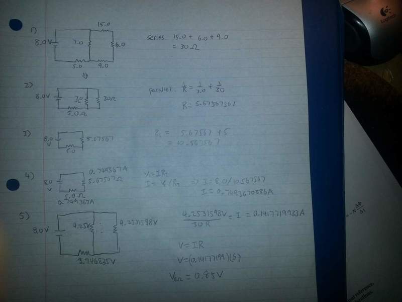

What is the potential difference across the 6.0 ohm resistor?
V=IR
I got my attempt on the question below on an attachment.
The final answer is 0.85V, if anyone can help me and confirm it, its greatly greatly appreciated.
