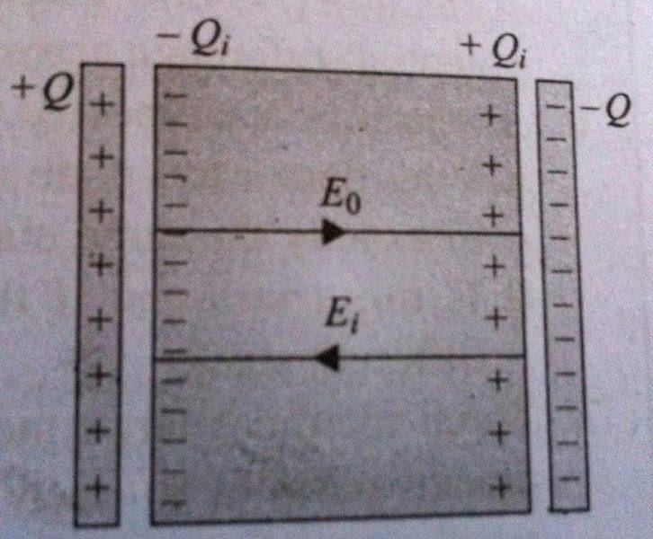

A parallel plate capacitor was lowered into water in a horizontal position, with water filling up the gap between the plates (gap d=1.0mm). Then, a constant voltage V=200volt is applied to the capacitor. Find the increment of pressure in the water between the gap.
F=qE
Diagram of a dielectric slab between two charged plates: outer plates labelled +Q and -Q, the slab's left and right faces labelled -Qi and +Qi, field E0 pointing right in the upper region and Ei pointing left in the lower region, with polarization charges shown as + and - signs along the slab faces.
Let the slab represent water between the capacitor plates. On the left surface, the field due to the left plate is ##\frac{\sigma}{2\epsilon_0}## along negative x-axis and that due to the right plate is also ##\frac{\sigma}{2\epsilon_0}## along the same direction. Total field on one surface is ##\frac{\sigma}{\epsilon_0}##.
Same force acts in opposite direction on the surface on the right.
This tends to expand the dielectric.
Let induced charge density on water be ##\sigma'##
Therefore, $$F=qE=\sigma'A\frac{\sigma}{\epsilon_0}$$
And $$P=\sigma'\frac{\sigma}{\epsilon_0}$$
But answer given is $$P=\frac{1}{2}\sigma'\frac{\sigma}{\epsilon_0}$$
Where does the 1/2 come from?
The contribution to the total electric field on the surface due to the plate dipped in water is reduced k times as a dielectric that is water is present in between.
