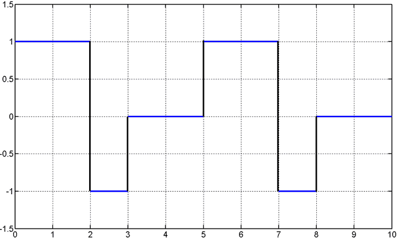

This is the given function:
The RMS equation goes like this:
[tex] \sqrt(\frac{\int(f(t)^2 dt)}{b - a})[/tex]
The first part of the exercise was to find the mean value.
This is A/4.
The RMS value should be higher than the mean value, but I need the function to use the equation and I can't "see it" from the picture.
RMS == the square root of the average of ( the square of the signal).
You are given a graph of the signal. On the same axes you can plot the signal squared, then determine the average of this. Then ...
Ah, thank you for putting it into perspective
RMS value = A/2
And it's not called a strange column function. It's called pulsed DC. Or 25% duty cycle switched DC. :smile:
duly noted ^^
And what happends if the "pulsed DC" varies between +1 and -1 V ? The signal squared = 1V anyhow (except for a few 0V periods)
Never mind. I got it :)
I made it too complicated at first
Then it's called a strange column function.
What you have sketched doesn't tally with your verbal description. For what you sketched, its RMS value will be equal to that of a 60% duty cycle switched DC, since a level of -1 contributes the same as does +1, in determining RMS value.
the second picture is another problem which I had to determine the mean and RMS value.
the problem description does not mention any DC or functional description of the graph
You could call it a stepped waveform. Maybe a staircase.
