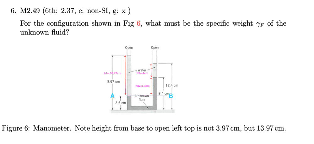

Hey everyone!
Here is the problem I have been tackling but did not end up with the correct answer
The extra red arrows I have labelled in myself and called these distances h1,h2 and h3. I assumed the pressure to be the same at levels A & B, hence i have established expressions for both of these and got the following
However this is not right and the right answer is actually 13.0 kN/m3. What did I do wrong exactly?

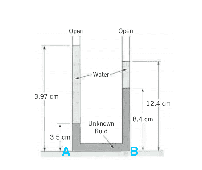

Nevermind I think I got the right answer now by doing something slightly different. I repositioned A & B to to be at the bottom of the manometer on both sides like this
I redid the method I used before in my first post. I got specific weight to come out as 12.95320... kN/m3 which is approx 13.0 kN/m3 to 3 sig figs
