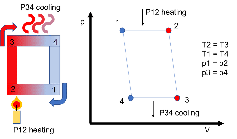

I don't know if I understand you all. I would like to be clear.
If I have a simple circuit without turbines.
Flow rate 1kg/s
a height of 1km with perfect thermal insulation.
And one column with water has a temperature of 90°C and the other has a temperature of 95°C,
How much power do I need down to heat the liquid and how much cooling power do I need up to cool the liquid.

  • #37
russ_watters said:
You're not giving us all the details of the cycle and making us guess. We don't like that. We can't tell if the numbers work unless we see them in the context of the rest of the cycle.
I apologize for reindexing the variables, but they make better logic for the p-V diagram.
1kg/s flow rate
Line 1-2 lower pipeline, pressure 10MPa. Heating P12= 20.93 kW ? +36W ?
Point 1: 90°C, Ro1=0.96978 g/ml, Enthalpy: 384.73 kJ/kg , Cp=4.1837 J/(g.K)
Point 2: 95°C, Ro2=0,96641 g/ml, Enthalpy: 405,66 kJ/kg , Cp=4,1884 J/(g.K)
Line 2-3 gravity hot water rise without pump. Height 1000m
Line 3-4 upper pipeline, pressure 0,1MPa, Cooling P34= 21,04 kW
Point 3: 95°C, Ro3=0,96189 g/ml, Enthalpy: 398,1 kJ/kg , Cp=4,2102 J/(g.K)
Point 4: 90°C, Ro4=0,96531 g/ml, Enthalpy: 377,06 kJ/kg , Cp=4,2052 J/(g.K)
Line 4-1 gravity descent of cold water. Height 1000m
Problem: P34 > P12
Did I make a mistake somewhere?
Is gravity bringing some energy in there ?

This is much better than before. So let’s look at what you have and what you are still missing (you keep jumping to the end without completing the middle)
Process 1-2 appears to be isobaric heating given the graph, but you never specifically state it. Please confirm?
Similarly process 3-4 appears to be isobaric cooling. Correct?
Now, the real confusion. You have previously described the process 2-3 as adiabatic. But now you are describing it as isothermal decompression. It cannot be both. Please clarify?
Similarly with process 4-1. Is it isothermal or adiabatic compression?

From the start it is 2 columns, one cold and one hot, ideally thermally insulated.
T2=T3 and T4=T1
this process of 2-3 and 4-1 is therefore isothermal
The columns are top and bottom connected. (Consider the free natural circulation of water, using the different densities of hot and cold water in the columns)
p1=p2 and p3=p4
then heating 1-2 and cooling 3-4 is an isobaric process
(if I strayed from this idea, it must have been a mistake)
(Now I only cancelled the turbine, which was supposed to take any of electricity from the natural circulation of water. Even without this complication we have an inequality of inputs and outputs.)

This is self contradictory. If you want T2=T3 (isothermal) then it cannot be thermally insulated (adiabatic). You have to choose.
  • #41
can you give me some advice, please? What is the process? (I've always solved the adiabatic plot with gas/steam only.)
Column 2-3 is full of water and is ideally insulated. The column does not trap heat, nor does it accept heat from the surroundings.
If the volume of water increases slightly, because as it rises 1000m upwards, the hydrostatic pressure decreases, then can't T2=T3 ?
Originally I didn't think to consider water compressibility, then T2 = T3. But by 1000m is consider compressibility water as realy number

So it sounds like you want adiabatic, not isothermal.
Consider a gas. As a gas expands adiabatically it reduces its temperature. And as it compresses adiabatically its temperature increases. So an adiabatic process is not isothermal.
The same happens in a liquid, but just to a smaller degree. But since you want very high precision then you must consider these things.
So what you need to do is find the fluid properties at 10 MPa and 95 C using the earlier website. Then you calculate ##P V^{\gamma}## where ##\gamma=C_P/C_V##.
Once you have that number then you go to 0.1 MPa and you find the temperature with that same number.
I get 94.78 C. Not much lower than 95 C, but you were not looking for a big difference.

Thank you, I think you have found my lost energy.
