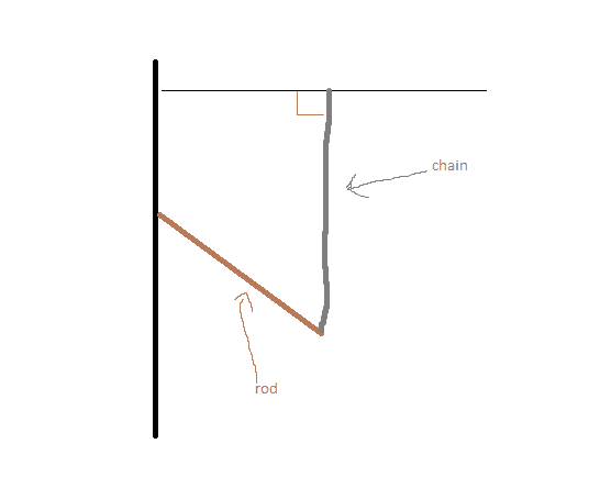

seems like Torque = r f sin theta should be used here but we don't know r.
Am I suppose to find the x and y components of the tension of the chain?
off topic : if the chain was moved so it would just be above the end of the rod, just like this :
, would it put less tension on the chain?
For variables you don't know, adopt a symbol and go to work. Good chance the thing will drop out towards the end.

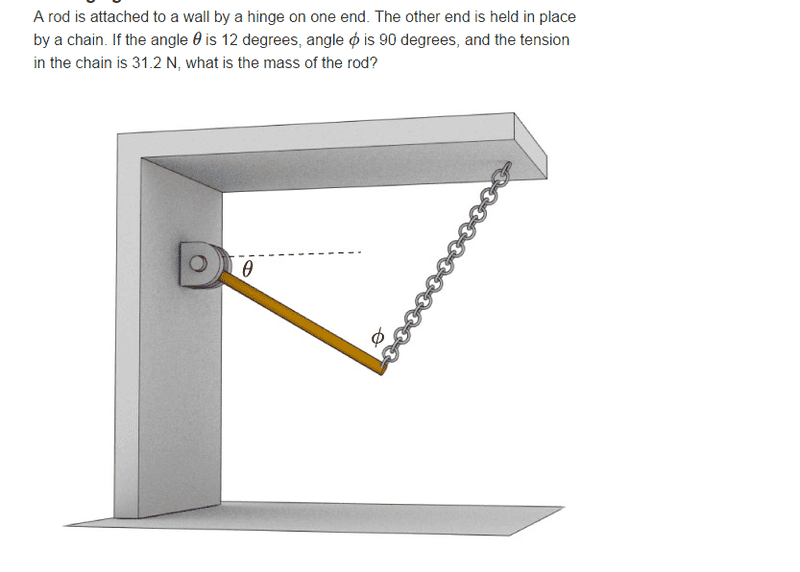

No the chain is in the proper angle to help you calculate the torque of the tension of chain easily ##T_1=31.2r## where r is the length of rod. This torque will be countered by the torque of the weight. Can you find what is the angle ##\phi_1## that the weight makes with the line of rod and then find the torque of weight? You then can see that r is simplified when equating the two torques.
Problem solving systematics urges you to list the relevant equations and the given/known data.
You do know them already and you do use them already, but still it's a good way to get a grasp on an exercise.
In this case you want ##\Sigma\;\tau = 0## and indeed need ##\tau = \vec r\times\vec F = r F \sin\theta## but this ##\theta## is not the ##\theta## in the drawing that comes with your exercise.
i'm not sure where you mean ϕ1. by weight, do you mean the right end of the rod?
No i mean the force of weight due to gravity... Can you draw a diagram with all the forces acting on the rod?
should be 78 degrees
Ok correct, now what is the torque of weight?
r f sin 78
f = mg
Not exactly. The force of weight is considered to be applied at the c.o.m of the rod. Where is the c.o.m of rod?
at the middle of the rod
ok so you have the weight acting on the middle of the rod, at an agle of 78, so what is its torque?
r/2 x mg x sin 78
Delta² said:
yes correct.
do we need the torque of the chain? or is that given by the tension in the chain?
yes you need the torque of the chain. I already said in post #4 what it is. Equate the two torques and solve for m. What do you get?
torque of chain = r 31.2
r 31.2N = r mg sin 78
m = 3.544kg
Didnt we say the torque of weight is (r/2)mgsin(78)
whoops, yes
r 31.2N = r/2 mg sin 78
m = 6.5 kg
yes correct. what value did u use for g just asking.
9.8
still having a bit of trouble understanding why torque = 31.2 r
isn't the chain at an 78 degree angle too?
No. The force from the chain is acting perpendicular to the rod and therefore has the full length of the rod as the moment arm.
Edit: It would have a 78 degree angle if it was positioned as in your drawing, but it is not.
i see, thank you.
