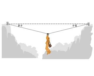

An adventurous archaeologist crosses between two rock cliffs by slowly going hand-over-hand along a rope stretched between the cliffs. He stops to rest at the middle of the rope. The rope will break if the tension in it exceeds 2.25*10^4N, and our hero's mass is 86.9kg.
If the angle between the rope and the horizontal is θ=11.7°, find the tension, T, in the rope.
ƩF=ma
ƩFx=max
ƩFy=may
All I could think of doing was breaking everything down into components, but I still can't get it right. Since θ is 11.7° below the horizontal (from the x-axis down 11.7°) [I will attach a picture], I took the components of the tension. Doing this, I got Tx=Tcos(11.7) and Ty=Tsin(11.7). Since the man is in the middle of the rope, it would mean that there is an equal vector of Tx and Ty on each side of the man. No matter how I break it up, I get: 2Tx=max and 2Ty-mg=may. No matter how I set up the equations, I am left with 2 unknowns, so I don't know if I am missing something or doing something wrong.

The man remains at rest, so what is his acceleration? As for the x direction, are the signs of the tension on the left and right the same?
That is where I got confused. Taking another look at the problem, I realize that Tx in each direction are the same. Does this mean that: ƩFx=0? If so, in the equation ƩFy=may, does ay=-g?
Yes, obviously, since there is no acceleration.
No. Again, there is no acceleration, so the vertical forces must cancel.
Your original equation in the y-direction was correct, except that ay=0. So solve for Ty, and then use the trigonometric relation in the y-direction to back out the value of T.
