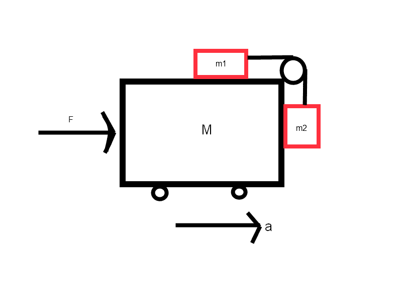

In the picture:
http://postimg.org/image/6gdkm5vpx/
There is a force (F) pushing the car to the right
The car's mass is M
There are two other objects with masses m1 and m2 that are connected by a cord with no mass.
There is no friction
In terms of m1, m2 and M find the acceleration needed to keep m1 and m2 from falling down.
This is the second Newton's law.
The only equation I use is
Fnet=m*a
I have tried doing this by placing the 3 m's (m1, m2 and M) in their respective Cartesian planes to get the forces of each one, but the part I don't quite understand is which forces I have to put in the formula...
I understand that I need to add the masses:
Fnet=(M+m1+m2)*a
and I understand that Fnet consists of the F force that is affecting the car, but what other?
Do I need to use the tension of the cord that holds m1 and m2 together? or all I do is:
F=(M+m1+m2)*a
So the acceleration would be
F/(M+m1+m2)=a ?

Well the forces in each mass are:
m2: T(tension) and W (weight)
The tension in this case is equal to the weight which is mass*gravity
So T=m*g
and in m1 the forces are weight, Normal force (I don't know how it's called in English but I hope you understand) and the tension which is m2*g, there is no acceleration in Y so I don't need the weight or normal force.
Do I need to use this information to find the car's acceleration that's needed to keep the masses from falling? or is it just the total of the masses and the external force (F)?

What force is required to accelerate m1 with acceleration, a ?
So T=m*g
Good. You found the tension. So what's the acceleration of m1?
That would be T/m=a right?
That's right. (I think you mean m1, not m.)

Are you sure you are posting the problem exactly as given, word for word?
The problem seems a bit over specified. Given the constraints, you should be able to find both the acceleration and the force F in terms of the masses.

It's true in a trivial sense. Given the force, the acceleration must equal what you claim. But they ask for the acceleration in terms of the masses, not the force F (presumably unknown). So I do not think that's the answer they want.
I'm guessing that the instructor meant this as a two part question:
(1) What's the acceleration? (In terms of the masses, not the force F.) You already solved that!
(2) What's the force F needed to produce that acceleration?
So far, it seems you were asked question 1.
This is a tricky question--you are doing great!
So T=m2*g
Correct. :smile:
Correct.
So your F = ma equation for the X direction is … ?
(if you just keep going, i think you'll find the final answer is simpler than you thought! :wink:)
