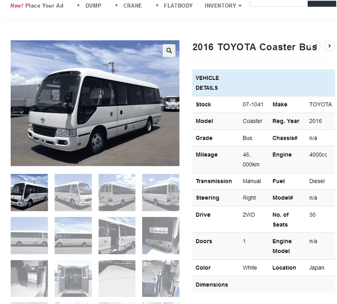

I'm not sure it's realistic to try to power an EV bus only with the solar panels on its roof. That does not give you enough energy per day to recharge the batteries to drive around. How much driving per day do you want to do with this EV motorhome?
https://casstrucking.com/product/2016-toyota-coaster-bus/

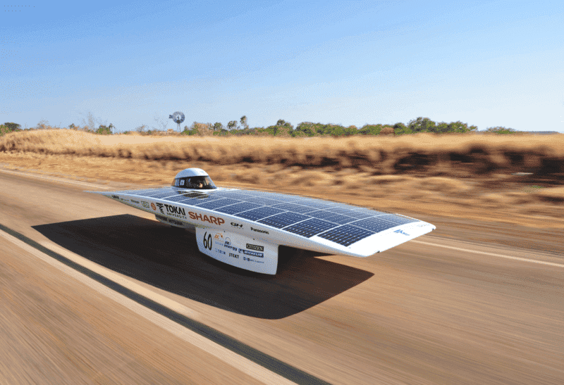

But even in your local EV conversions, those vehicle batteries are being recharged each night from the home's AC Mains wall sockets, no? Not just via roof-mounted solar panels I hope.
It takes very specialized lightweight small vehicles to try to run on sunlight alone (in competitions in bright sunlight, mid-day, etc...)
https://en.wikipedia.org/wiki/Solar_car

of course I wasn't trying to imply that he will be able to run a bus on solar alone. That solar might help with the auxiliary needs of the bus like lights, etc but for driving power it won't do.
