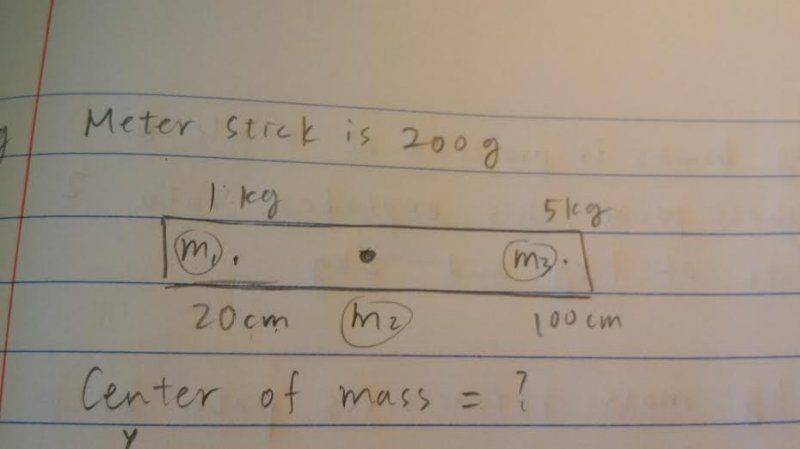

A meter stick is 200 g. A mass of 1 kg is placed in 20 cm, and another mass of 5 kg is placed in 100 cm.
So the diagram will be like:
Why do we have to include M2? And why is the mass of M2 is 200g? Isn't the whole meter stick weight 200g, and ithe mass of M2 should be lighter because it is just a point on the meter stick.
Center of Mass = [(1)(0.2) + (0.2)(0.5) + (5)(1)] / (1+0.2+5) = 0.8548
The distributed mass of the meter stick can be taken as being concentrated at the center of mass of the stick itself.
Center of Mass = (1)(0.2) + (0.2)(0.5) + (5)(1) = 0.8548
This is not the equation for the center of mass. There is supposed to be a denominator on the right hand side. Please write the correct equation for the location of the center of mass.
