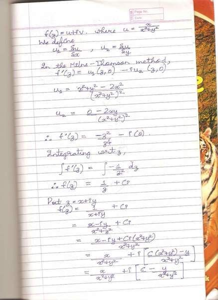

You could use the Milne-Thomson method to construct complex functions...
Note : Pardon the handwriting in the image. C is the integration constant. Also, if you've been given the imaginary part of the complex function, you can use f ' (z) = v1(z , 0) + i v2(z , 0).
