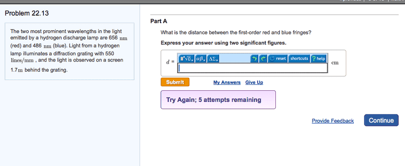

rocapp
95
See attached image
single wavelength
mλ=dsin(θ)
diffraction grating:
d*(sinθi+sinθm)=mλ
y/L = sinθ
red = 656 nm
blue = 486 nm
L = 1.7 m
I really do not know what to do.
I tried 656-486 = 170 nm
so
y/L = sinθ
0.000017 cm/ 170 cm = sinθ
θ=5.73x10^-6
and that does not yield a correct answer.
Please help! Thanks in advance.
  • Screenshot of an online physics homework problem 22.13 asking for the distance between first-order red and blue fringes, with an answer entry box in cm and a Try Again message.

Work out the spacing for the fringes of each wavelength separately.

Check it now; I re-uploaded.
Which equation should I use? I realize that I can plug in lambda for each wavelength into two different equations, but I don't see how I can use the given information to find d. I have no y-values. I have never used the diffraction-grating formula, but it requires an incident and reflecting value for theta and I do not have these.
All right - the situation is that you have a diffraction grating with 550lines/mm, a screen 1.7m from the grating, and the red and blue hydrogen discharge lines.
You want to find the distance between the 1st order fringes.
In order to use equations in physics you have to understand them. You should go back over your notes about how the fringes form in the first place.
In the equation ##d\sin\theta = n\lambda## - the ##d## is the distance between the lines on the diffraction grating, ##\lambda## is the wavelength of the light, ##n## is the "order" of the fringe, and ##\theta## is the angle from the center of the grating to the fringe.
You can find the angle to each fringe with this formula - but you need some way to turn those angles into distances on the screen.

my mistake! Geez I must have been tired when I was doing that. The correct answer is:
1/550=0.00182 mm
So in cm:
(1.82x10^-7)*sin(theta) = (6.56x10^-5)
sin(theta) = 360.44
theta = 90 degrees.
Still getting it. :P

So dsin(theta) = m(lambda)
1.82x10^-3 mm * sin(theta) = 1 * 6.56x10^-4 mm
sin (theta) = 0.360
theta = arcsin(0.360)
theta = 21.13 degrees
for the blue maximum's distance
d*sin(theta) = m*(lambda)
(1.82x10^-3 mm)*sin(theta) = 1*(4.86x10^-4 mm)
arcsin()
For the red maximum's distance
y = L*tan(theta)
y(red) = 1.7*tan(21.13)
y(red) = 0.657 mtheta blue = 15.49 degrees
y blue = 0.471 m
delta y = d = 0.186 m
So the distance between the two maxima should be 0.186 m.
Please let me know if this answer is correct; it is due tomorrow.
That is much better - see how this kind of discipline works out?
To reality-check your own answers - do what I was doing before: work out what they mean.
Before: your data was telling you that the hypotenuse of a right-triangle was smaller than the other sides - which does not make sense, therefore you were probably wrong. After a while you get used to thinking this way: the problem is not over just because you have finished the calculation.
This last result means that if you fed white light into the diffraction grating, you get a white central maxima, and a series of rainbow-colored fringes to either side. The red part will be farther away from the center than the blue part, and the individual fringes will be about 186mm wide. If all this makes sense then you have probably go it right.
Just an aside - normally, where L >> d (as in this case) then ##\tan\theta \approx \sin\theta \approx \theta## (using radians instead of degrees) and you can say that ##n\lambda/d \approx x/L## and you can do it in one step.
Since ##x=\frac{L}{d}\lambda## then ##\Delta x = \frac{L}{d}(\lambda_{red}-\lambda_{blue})##
Do get used to using radians by default for angles.
