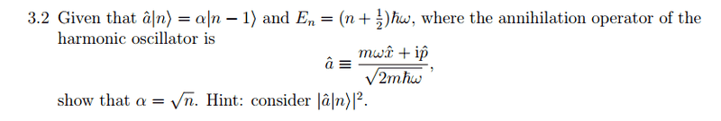

Given the a|n> = α|n-1>, show that α = √n :
[tex]<n|a^{+}\hat {a}|n> = \alpha <n|a^{+}|n-1> = | \hat a|n>|^2[/tex]
[tex]\alpha = \frac{<n|a^{+}\hat {a}|n>}{<n|a^{+}|n-1>}[/tex]
Taking the complex conjugate of both sides:
[tex]\alpha* = \frac{<n|a^{+}\hat {a}|n>}{\alpha<n-1|n-1>}[/tex]
[tex]|\alpha^2| = \frac{<n|a^{+}\hat {a}|n>}{<n-1|n-1>}[/tex]
Where ##\hat {a} a^{+} = \frac{1}{2m\omega} \left( (m\omega x)^2 + p^2 + im\omega [\hat{x},\hat{p}] \right) ##
nice work. I think you're getting there. although remember that ##\alpha## isn't necessarily real, so when you took the complex conjugate of both sides, you should also take complex conjugate of ##\alpha##. For the final equation you wrote down, I think that is the right idea. But it's definitely missing some ##\hbar## and the square root should not still be there. it's just a minor mistake.

The problem is, I have no idea how to proceed now..
once you've fixed the minor mistake, you have the operator ##aa^\dagger##. what other operator does this operator look like? hint: the physical model of this system is simple harmonic motion.

Okay, The square root has gone away, due to it appearing twice from a and a+ and I've fixed the square term in the bracket.

USing ##[\hat x,\hat p] = i\hbar##
[tex]\hat a a^{+} = \frac{\hat H}{\hbar \omega} - \frac{1}{2}[/tex]
[tex]|\alpha^2| = \frac{<n| \frac{\hat H}{\hbar \omega} - \frac{1}{2}|n>}{<n-1|n-1>}[/tex]
How do I proceed from here?
hmm. wait hold on, since they ask you to consider ##|\hat{a}|n\rangle |^2## I think you should use the operator that you were originally working with, ##\hat{a}^\dagger \hat{a}##

How do I evaluate the inner product:
[tex]|\alpha^2| = \frac{<n| \frac{\hat H}{\hbar \omega} - \frac{1}{2}|n>}{<n-1|n-1>} = \frac{<n|a^{+}\hat {a}|n>}{<n-1|n-1>}[/tex]It should give ##n## on the RHS.
you're almost there now. In the question, they tell you ##E_n = (n+1/2)\hbar \omega## they mean this is the energy of the ##|n\rangle## eigenstate. so this should be enough to evaluate that inner product.

How do I evaluate the numerator?
[tex]<n| \frac{\hat H}{\hbar \omega} - \frac{1}{2}|n>[/tex]
[tex]= \frac{1}{\hbar \omega} <n|\hat H|n> - \frac{1}{2}<n|n>[/tex]
[tex]= \frac{E_n}{\hbar \omega}<n|n> - \frac{1}{2}<n|n>[/tex]
[tex]= \left (\frac{E_n}{\hbar \omega} - \frac{1}{2} \right) <n|n>[/tex]
Thus,
[tex]|\alpha|^2 = \left (\frac{E_n}{\hbar \omega} - \frac{1}{2} \right)\frac{ <n|n>}{<n-1|n-1>}[/tex]
[tex]|\alpha|^2 = n \frac{ <n|n>}{<n-1|n-1>}[/tex]
yep. that is good so far for the numerator. But the denominator is not (n-1)2. each of the ##|n\rangle## are states, right? so what (conventionally), is the inner product of the state with itself?

Can I assume they are linearly independent, and have norm = 1?
yeah! I guess it is not obvious really. But I think in these kinds of problems, you can assume that if they give you a set of states, those states will be orthonormal. (unless they say otherwise).
