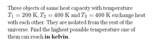

Let the specific heat capacity of each object be ##C##, then
C(T-200)=C(400-T)+C(400-T), where T is the final temperature.
But solving this gives T=333.33 K which is wrong. :confused:
Any help is appreciated. Thanks!

Contemplate upon the second law of thermodynamics.

The problem says nothing about how they exchange heat (radiation, conduction, convection,...). But it does say that they form an isolated system. That means no heat escape, no external forces or energies.
Can you quote a statement of the second law of thermodynamics? Hint: If heat moves between the given objects, will the heat flow spontaneously from an object of lower temperature to one of higher temperature?

From Wikipedia: "The second law of thermodynamics states that the entropy of an isolated system never decreases, because isolated systems spontaneously evolve towards thermodynamic equilibrium—the state of maximum entropy."
No, the process is not spontaneous. But I am still unsure about what equations to start with.
Note the phrase, "isolated systems spontaneously evolve towards thermodynamic equilibrium". That means heat, if it moves, moves from things of higher temperature to things of lower temperature. When everything has the same temperature then the system is in equilibrium.
Here we have three objects with starting temperatures. Which of the objects can achieve a higher temperature if heat always moves from higher temp to lower temp? Can the highest available temp increase?
No equations are required! Just the second law and its consequences.

In principle, the flow of heat from one of the hotter bodies to the cooler body can be used to drive some heat up the gradient to the other hot body. I know it says there are just these three bodies, nothing else, but perhaps they are in the form of a heat engine. The details don't matter.
If we assume that the only constraints are conservation of energy and non-reduction of total entropy it will be possible to calculate a max temp (and it will be > 400K). I gather that you will then be able to check if it's the accepted answer.

Let the bodies be A, B (each 400K) and C. Suppose we arrange a small quantity of heat ΔQ to flow from A to C and use that to pump a further ΔR from A to B. Assume some arbitrary specific heat for all three. Write down the equations for no net change in entropy. This should lead to a differential equation.
Edit: For the purposes of the differential equation, you can treat one body in isolation to determine the change in entropy as its temperature changes from T1 to T2. Or you may already know a formula for that.

I don't think I still get it but here is what I get:
dS=\frac{dQ}{T}
##dQ=CdT##
\Delta S=C\ln\left(\frac{T_2}{T_1}\right)
Are you talking about this? I still don't see how this would help me. :frown:

Yes. Now, if the three temperatures change from TA0, TB0, TC0 to TA1, TB1, TC1, what is the total change in entropy? What other equation can you write relating those 6 variables (since the bodies have the same S.H and mass)?
Total change in entropy:
\Delta S_{total}=C\ln\left(\frac{T_{A1}}{T_{A0}}\right)+C\ln\left(\frac{T_{B1}}{T_{B0}}\right)+C\ln\left(\frac{T_{C1}}{T_{C0}}\right)

Good. Now, for max final temp, you can assume entropy stays constant. That will greatly simplify the above equation. You also know that total energy is constant. Express that using the same six variables. You know the initial temperatures, so it leaves you with three unknowns and two equations. We need one more equation.
Suppose that we start with A and B at 400K and C at 200K, and we use A to heat B and C. When we can pump no more heat into B, what can you say about the temperatures of A and C?

As the entropy stays constant
T_{A1}\cdot T_{B1}\cdot T_{C1}=T_{A0}\cdot T_{B0}\cdot T_{C0}
For energy conservation, I don't think that the following equation is correct,
C(T_{A1}-T_{A0}+C(T_{B1}-T_{B0})+C(T_{C1}-T_{C0})=0
I really have no idea about the third equation. When A heats B and C, the temperature of A decreases and that of C increases.

Apart from a missing parenthesis in the second, both equations look right to me. You can cancel the C in the second and rearrange more like the first equation.
Yes, but remember its the down gradient flow from A to C that we're using to pump heat into B. That can only continue until... ?

... until there's no gradient, which will mean the temperatures of A and C will be...?

Right, but what does that tell you about the difference between the temperatures of A and C at that point?

But I want to make sure there is no confusion here in the problem statement. It's not asking for the final temperature of the objects.
The temperature of each object is a function of time. At time t = 0, the temperatures of each object is specified to be:
T_1(0) = 200 \ \mathrm{K}, \ \ T_2(0) = 400 \ \mathrm{K}, \ \ T_3(0) = 400 \ \mathrm{K}.
A long time later (Edit: assuming the heat exchange lasts forever*),
T_1(\infty) = T_2(\infty) = T_3(\infty) = \mathrm{Some \ other \ temperature}.
But the problem statement is not [well, technically not necessarily] asking you what that final temperature is. Rather it's asking you "what is the maximum possible temperature anyone of them can have from the time t = 0 to the time t = \infty."
*(If the heat exchange doesn't last forever, it means the final temperature of each of the three objects will be different. But there is still something that can be said about the maximum temperature that anyone of them can have from the time 0 < t < \infty, given the second law of thermodynamics.)

No, I mean the point at which there is no gradient. When no more heat can be pumped into B, the temperatures of A and C will be equal, right? That gives you your third equation.
From these you can extract a cubic in one unknown. Now, solving a cubic is a lot easier if you happen to know one root. Here's where the problem setter has been kind to you - you do already have one solution to it. (Hint)
I'm sorry to interject here again, but I really want to make sure we're all on the right page with the original problem statement.
The original problem said, "Find the highest possible temperature one of them can reach in Kelvin."
We know object 2 and object 3 started out at 400 K.
So the final answer (to the original problem statement) must be greater than or equal to 400 K.
Can it be greater than 400 K? The first law of thermodynamics does not prohibit that. But what about the second law? How does the second law fit in here?

On the basis that the max temp achievable will correspond to no change in entropy, that produced the equation "product of absolute temperatures = constant".
