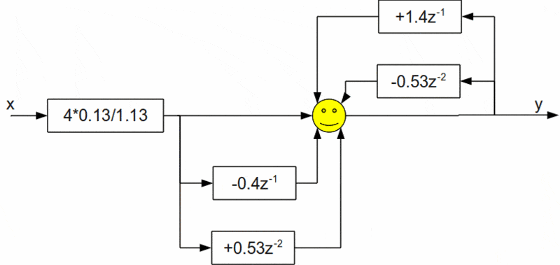

Let's see...
Can you calculate the transfer function H(z) and the recursive relation for this block diagram?
Btw, that smiley is not part of the block diagram.
It's just to make the whole thing look less grumpy.

If I were to calculate the difference equation from your flow diagram I would get what I had before. Maybe I would add an x to the 0.46 term.
y(k)=1.4y(k−1)−0.53y(k−2)−0.184x(k−1)+0.244x(k−2)+0.46x ?
Yeah... that should be x(k), so:
y(k)=1.4y(k−1)−0.53y(k−2)−0.184x(k−1)+0.244x(k−2)+ 0.46x(k)
Makes sense. I knew something was off with it. It makes sense though. Thank you so much for the help. I really appreciate it!
