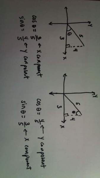

You cannot say that cos θ is linked to the vectors in the x direction. That is only the case when the angle is measured against the horizontal. There are cases where you will use sin θ to calculate the x components (see attached image).
This is part of the reason I believe it is important to not to try and make such qualified statements. If you automatically say Vx = Vcos θ, there are times when you will be completely wrong. The best method is learn and memorise your trig functions using adjacent, opposite and hypotenuses (hypoteni?). cos = adj/hyp, sin = opp/hyp, tan = opp/adj.
However, having said all of that, in this particular case you are correct.
EDIT: I hope this doesn't appear as if I am talking down to you. I tend to get 'proper' when writing and I know that it can, at times, come off that way. This is something that I've seen cause SO many problems and so much frustration, that if this can help you avoid that it's well worth it! -r
