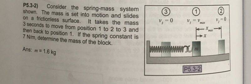

What is the mass of the block?
Given: friction less surface, velocity at each marked point, distance between points 1 and 2, spring constant l = 7 N/m
F=ma
Kinematic equations

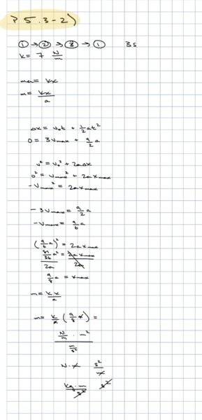

I tried to solve for a in m = F/a in order to find the mass. My units don't seem to agree, which suggests I have done something wrong.

Can't read your work image. Too small and fuzzy. Please type it out.
Edit: Also a hint: What's the formula for the period of a spring-mass system?

No, you are not given any distance nor any velocity.
Yes, from the little I make out in the image of your solution, you are trying to solve this using the kinematic equations for constant acceleration. That's not the case here at all.
Can't be using formulas for periods, haven't technically learned that yet. Must use other methods. Sorry about the image

Can you solve differential equations?
Also, unless you post something more readable, you are not likely to get many replies.

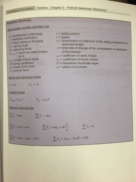

Yikes! I recall that this was one of the "given" formulas that I was presented with in high-school physics (without proof at that time) to use when faced with these sorts of problems.
Can you list the equations related to this type of problem that you've been given?

Yeah, that image just about impossible to read. But I don't see anything recognizable as being specifically related to harmonic motion. So that's going to pose a significant problem if you haven't done differential equations. Since the problem statement specifically points out the period of the harmonic motion, it seems strange that you haven't been introduced to the equation for the period of a spring-mass oscillator.

What topics / equations are covered in this section of the book ?
Literally just F=ma in various forms (normal tangential, polar) and a damping force was mentioned F = c * (dx/dt). also F = kx.
I find it hard to fathom that you've been exposed to the concept of damping yet haven't been taught the formula for the fundamental period of a spring-mass system. If I may ask, what course (in your school) does this question come from?
Here's an idea:
See if you can relate the motion of the mass attached to the spring, to the x or y component of the motion of a mass undergoing uniform circular motion where the centripetal force is ##\ k\cdot x_\text{max}\,,\ ## the radius of the circle is ##\ x_\text{max}\,,\ ## and the mass travels the complete circle every 3 seconds.
In order for this to be reasonable, the x or y, component (whichever you use) of the centripetal force should match the spring force at corresponding positions.
