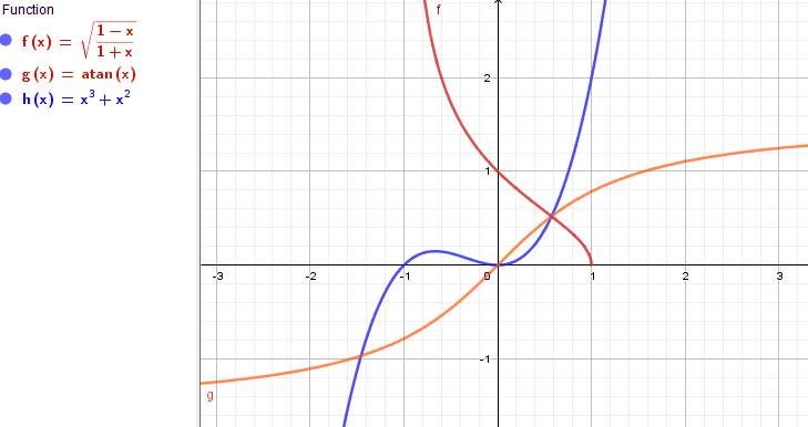

You should not think of the derivative as being a condition for a minimum, but rather a symptom of a certain type of minimum. There are a few different ways that a function can have a minimum. When one is asked for a global minimum, he must first get a general idea of the global behavior of the function. It can have a minimum that it achieves as your function does (function f(x) below), or it can have an asymptotic limit as x goes to -∞ (function g(x)), or it can have a local minimum where the derivatives indicate a minimum that is not a global minimum (function h(x)).
FactChecker said:
You should not think of the derivative as being a condition for a minimum, but rather a symptom of a certain type of minimum. There are a few different ways that a function can have a minimum. When one is asked for a global minimum, he must first get a general idea of the global behavior of the function. It can have a minimum that it does not achieve as your function does (function f(x) below), or it can have an asymptotic limit as x goes to -∞ (function g(x)), or it can have a local minimum where the derivatives indicate a minimum that is not a global minimum (function h(x)).
