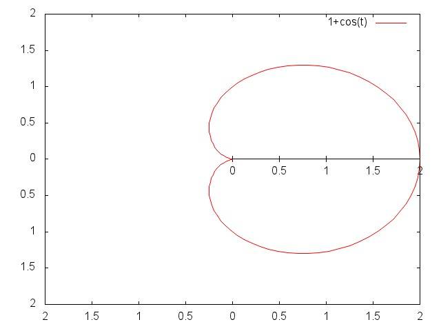

I have a problem with your orbit ##r=a(1+\cos(\theta))##. I plot the orbit with ##a=1##:
How could this be an orbit of a central force? Not likely.
If, however, the orbit is described by ##r=\frac{p}{1+e \cos(\theta)} ##, you could show by analytical geometry that the orbit is an ellipse with ##e## the eccentricity. So work out the orbit of the particle in a central field using center of mass coordinates. You will get an expression for the angle in terms of the radial distance, total energy, angular momentum, potential field strength and mass. You will then be able to associate these parameters with ##p## and ##e##.

You can get a cardioid orbit from an inverse 4th power central force, ##F = - \large \frac{A}{r^4} \hat r##, where ##A## is a positive constant.
If you want this force to cause a particle of mass ##m## to trace the upper half of the cardioid ##r = a(1+\cos \theta)## starting from the position ##(r, \theta) = (2a, 0)##, then you would give the particle an initial velocity ##\vec v_0 = \sqrt{\frac{A}{12ma^3}} \hat \theta##
When the particle reaches the singular point ##r = 0##, it would require some sort of conjuring to make the particle rebound in just the right direction such that it can continue to trace the bottom half of the cardioid. We could fix a very small circular disk at the origin and assume that the collision of the particle with the disk is elastic. The particle would not quite make it to the origin, but if the disk has a small enough radius we wouldn't notice.
