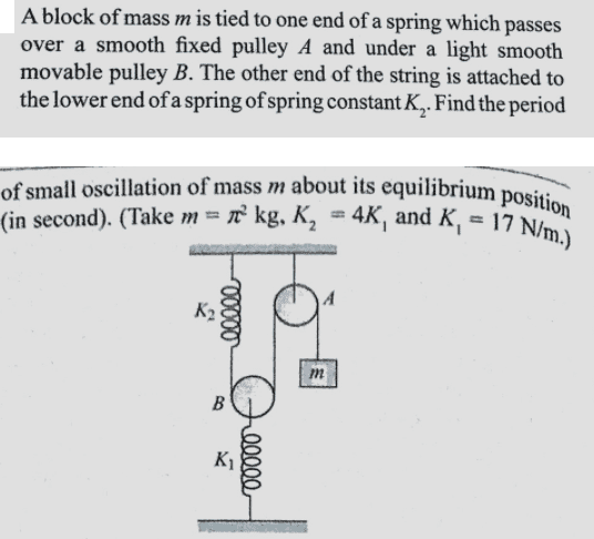

Please see below
Simple harmonic motion
Newton's law
This is not homework. I found this question when browsing and there is also solution but I do not understand it. This is part of the solution:
My questions:
1)
From equation (i): ΔT = m.a, I think ΔT refers to W - T (weight of block - tension of string). I got this from free body diagram and taking ##m## moving downwards. Is it correct that ΔT = W - T?
If yes, why the solution states "net increment in the tension in the string will provide acceleration to the block" ? Shouldn't it be "decrement" in the tension, since the tension must be less than the weight for ##m## to move downwards? I assume initially the system is at rest.
2)
Why the tension on left string connected to pulley A is also ΔT? Shouldn't it be T?
3)
I don't understand equation (ii):
$$x_1=\frac{x-x_2}{2}$$
When ##m## moves ##x## meter downwards, both spring 1 and 2 will extend by ##x_1## and ##x_2## respectively. How to proceed to get that equation?
Thanks

Hello again,
Check the signs: if ##m## is pulled down, ##\Delta T## is negative, as is ##ma## and the mass will accelerate upward as you would expect.
With ##\Delta T## they mean the increment wrt equilibrium
As for the other variables in the picture.
The ##x## to the left of ##K_1## should be ##x_1##.
songoku said:
When m moves x meter downwards, both spring 1 and 2 will extend by x1 and x2 respectively.
I don't agree with that.
By considering the length of the string !
I believe that is how ##x_1## and ##x_2## are defined.
... unless you are objecting to the extraneous words "meter" and "both".
songoku said:
... taking m moving downwards. Is it correct that ΔT = W - T?
If yes, why the solution states "net increment in the tension in the string will provide acceleration to the block" ? Shouldn't it be "decrement" in the tension, since the tension must be less than the weight for m to move downwards?
You are confusing the acceleration of the mass, its having moved downwards by some means, with the motion leading to that downward displacement.

BvU said:
Hello again,
Hello again BvU
What does it mean by increment with respect to equilibrium?
When ##m## moves downwards, the string will pull spring 2 downwards so it extends by ##x_2## and to maintain equilibrium (maybe) spring 1 must be pulled upwards to provide downwards restoring force to balance upwards restoring force of spring 2 and upwards tension. That is what I think
Length of the string is constant but sorry I don't understand how to apply that. If ##m## moves downwards ##x## meters, spring 2 extends downwards by ##x_2## then I don't know how to continue
I am really sorry, I don't understand this
This is how I will approach the problem.
(i) Draw free body diagram for ##m##, which will be T upwards and W downwards
(ii) Assuming the system starts from rest and ##m## going down after being released, I set up Newton's 2nd law equation of motion:
$$W-T=m.a$$
(iii) Since the pulley is smooth, all the tension of string connected to pulley A and B will have same value T, so since spring 2 is extended by ##x_2##, it means ##T=k_2.x_2##
Then I stuck
Thanks
The diagram should have identified the ##x## next to ##k_1## as ##x_1##.
songoku said:
Assuming the system starts from rest and m going down after being released
No, the mass m is hanging in equilibrium, then it is pulled down a small distance and released. Its acceleration will thereafter have opposite sign to its displacement from the equilibrium position.
Oh I see, so initially ΔT should be T - W since after released, ##m## will go upwards
Two things I still do not understand:
1) Why the force in the left of pulley A is ΔT, not T
2) how to relate ##x## with ##x_1## and ##x_2##
Thanks
Yes, but it is because ΔT is defined to be the amount by which T exceeds the equilibrium value, which is W.
The force is T, but, again, what we want is the amount by which the force exceeds the equilibrium value. That corresponds to the increase in extension beyond its equilibrium value.
If B moves up by ##\delta##, what are the changes in ##x, x_1, x_2##? So what combinations are constant?

songoku said:
Why the one being considered is the amount that exceeds the equilibrium value? The solution states that ##\Delta T=k_2.x_2## but from my own working I got ##T=k_2.x_2##
There should be no ##T## in your working. All variables appearing are zero at equilibrium. ##T## is not.
But ##x_2## is zero at equilibrium, so ##T = k_2x_2## does not hold. ##\Delta T = k_2x_2##.
##x_2## is not the extension of spring 2. It is the change in extension as a result of the mass moving away from its equilibrium position.
Suppose, at equilibrium, the tension is T. Then the extension of that spring is ##T/k_2##. A movement away from equilibrium increases the extension to ##T/k_2+x_2## and the tension to ##T+\Delta T##. So
##T+\Delta T=k_2(T/k_2+x_2)=T+k_2x_2##.
songoku said:
Maybe ##x_1=\delta##, and the string connected to the left and right of pulley B will be shorter by the same amount (?) so ##x_2=\frac{\delta}{2}## and ##x=\delta##?
Yes, ##x_1=\delta##. For the others, consider the total distance from the top of spring 2, round both pulleys and down to the mass. Since the string is constant, the increase in that total length is ##x_2##.
Now break it down into
- the section from the top of spring 2, to pulley B
- the section from pulley B to pulley A, and
- the section from pulley A down to the mass.
Since the distance from ceiling to floor is constant, each of the first two decreases by ##\delta##, while the third increases by x.

songoku said:
You mean the third increases by δ?
No, x. Look at the diagram: x is defined to be how much further m gets from A, so is the distance m descends.
songoku said:
If for this case, the string on the left and right side of pulley connected to ##m_2## will each decrease by amount of ##\frac x 2## if ##m_1## moves downwards as far as ##x##?
Yes.
songoku said:
If yes, why the section from the top of spring 2, to pulley B and the section from pulley B to pulley A, each decreases by ##\frac{\delta}{2}##?
I wrote that each decreases by δ, not δ/2. And I gave the reason in post #13.

songoku said:
I am sorry, my question should be: why the section from the top of spring 2, to pulley B and the section from pulley B to pulley A, not each decreases by ##\frac{\delta}{2}##
And sorry, I don't understand the hint about "the distance from ceiling to floor is constant". What it has to do with ##\delta## and ##x##?I don't need to state ##x## in terms of ##\delta##?
Thanks
If B moves up by δ then B is closer to the ceiling by that amount, so x1 is reduced by δ. Similarly, the vertical distance from ceiling to A is fixed, so the vertical distance from B to A is reduced by δ.
The steps I laid out in post #13 give you two ways of expressing the change in the total distance from the top of spring 2, round both pulleys and down to the mass. Equating these should give you the relationship between the three x variables.
Change in total distance from the top of spring 2, round both pulleys and down to the mass
= change in the section from the top of spring 2, to pulley B + change in the section from pulley B to pulley A + change in the section from pulley A down to the mass.
= ##x_2 - \delta + x## (where ##x_2= - \delta##)
Is this correct?
Sorry, I don't know the other way to express the change in total distance
Thanks
Is this correct?
No. I may have misled you with a typo in post #13, corrected.
The change in distance from the top of spring 2 to pulley B is not x2. x2 is the change in length of spring 2. But yes, the change in the section from the top of spring 2, to pulley B is ##-x_1=- \delta##.
Since spring 2 has extended by ##x_2##, and the string length is fixed, what is another expression for the change in that total length?
Using your hint, I already get the equation relating ##x,x_1## and ##x_2##.
I am just curious, is it possible to state ##x_1## in terms of ##x_2## only?
Thanks
Thanks
Since you have an equation relating x, x1 and x2, and you know x can vary, it is clear that the relationship between x1 and x2 varies.
