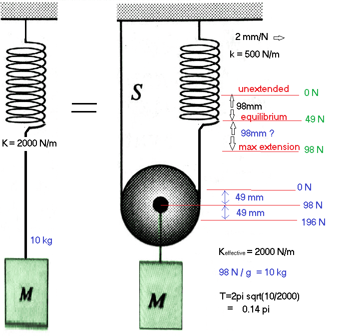

A mass M is attached to a free pulley and the pulley is attached to wire S and elastic spring (see diagram). The spring will extend 2.0 mm per Newton tensile force. When M is stationary, the extension of spring is 98 mm. The mass of pulley, wire and spring are negligible. M is pushed slowly upwards until there is no spring restoring force, then released.
a. by how far will M move down before it starts going up again? (answer = 392 mm)
b. find the period of the motion (answer = 0.2 π second)

I assume the pulley and mass move vertically. In the absence of measurements and distances, this seems the only sensible assumption. So I take the width of the pulley (diameter) to equal the distance between the anchor points for S and the spring.
I share your puzzlement. It looks as if the spring must stretch twice the movement of the mass.
They seem to say that the reverse is the case: the mass moves twice the distance of the spring stretch?
I do disagree with your 196 mm though.

It wasn't a hint! It was just saying that the person who set the question seems to be a bit confused. I assumed you had thought the same, because you already knew that their answer for (a) is wrong.
The point is, how much the spring stretches when the mass moves. Are they the same ?
Or to make it a multiple choice Q
a) mass moves 2 mm, spring stretches 2 mm
b) mass moves 2 mm, spring stretches 1 mm
c) mass moves 2 mm, spring stretches 4 mm
d) none of the above
The whole significance of this question lies in the role of the pulley.
A pulley can alter the amount of the movement and also the force.
For an ideal pulley these are in inverse proportion (due to conservation of energy: |work|or|force x distance| is the same on both sides of the pulley)
" ... a free pulley ... and elastic spring ... . The mass of pulley, wire and spring are negligible. "
To me that implies we have to assume the wire is light, inextensible and has no friction with the pulley or anything else. Therefore the tension is the same at all points along the wire.
Similarly the pulley has no effect other than that of an ideal pulley.What you need to show is, that the force on the mass is proportional to the displacement of the mass from the equilibrium position. (obviously with the correct sense)
You need to be clear about what your variables stand for. Is x the displacement of the mass, or the extension of the spring? Or what? Where is the tension? In S, or in the string connecting the mass to the pulley?
You didn't say what Ts and Ts' are. I'd just stick to one T for tension in any one place, but realize that it is a variable.
Or we assume Ts = Ts' (the tension of S is always constant)?
No, the tension in the wire is not constant. It is attached to the spring, so for the spring to stretch tension must be applied by the wireYou need to consider just one position where the mass is not at equilibrium.
(The other position is just to allow you to calculate the mass.)

I think the answer is (c).
So the answer to my question (a) is 98 mm?

I still don't get equation of simple harmonic motion.
Let say the mass has been released and it moves downwards until the spring extended by 98 mm, the free body diagram of the mass will be: tension T (between mass and pulley) acting upwards and weight acting downwards.
Equation of motion:
W - T = M.a
M.g - T = M.a
M.g - 2.k.x = M.a → from this equation, acceleration is not directly proportional to the displacement
Is the motion of M considered simple harmonic motion?
Thanks
I am not sure at all here but my opinion:
M does indeed simple harmonic motion but its amplitude is half of the maximum compression (or maximum extension) of spring from its relaxed position and for this is responsible the pulley.
Yeah, Delta's nailed the point. You're measuring displacement from the unextended position of the spring. That's why you've got an unwanted constant term
The restoring force needs to be proportional to the displacement from the equilibrium position.
You say
M.g - 2.k.x = M.a
and you know there is no accn. at equilibrium point. If your x were measuring from there, you'd have
M.g - 2.k.0 = M.0 or M.g = 0 obviously not right.

One thing that might be helpful, is to realize that the spring doesn't have to be the spring, just something that behaves like a spring.
So here the light frictionless pulley, wire and spring behaves just like a spring, with a different constant.
You can work out how much the force changes as the mass moves. That gives you the spring constant of your equivalent spring.
Here when the mass moves 1 mm, the spring stetches 2 mm, requiring 1 N tension in the wire, so via the pulley, 2 N at the mass. So the imaginary spring is 2 N per 1 mm, giving K = 2000 N/m
