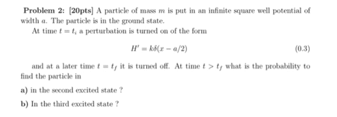

The question is attached below

The relevant expression for probability of transition to find the probability of transition from intial state to final state when the perturbation is turned at t=0, after that perturbation will not be turned off.
But the question asked is to find the transition probability after the perturbation is turned off. Will turning off pertubation after some time will affect the expression for transition amplitude that I mentioned?
