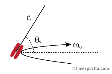

Some kid is playing with a yoyo of mass m. The yoyo string is let out to length L, and is spun in a horizontal circle at a constant rate of ω. The yoyo string makes an angle of θ with the horizontal
m = 39 grams = 0.039 kilgrams
L = 46cm = 0.46m
ω = 3 rads/sec
Calculate the tension in the string in Newtons.
Tx = Tcosθ = mω2r = mv2/r
Ty = Tsinθ = mg = 0.3822N
r = L cosθ
h = L sinθ

This should be sufficient to get tension in the string in terms of given parameters.

You do not require θ .
Tcosθ = mω2Lcosθ .

So T = mω2L...

Sorry...I do not understand your question.The net force in the radial direction is Tcosθ and this force is equal to the centripetal force given by mω2r .Here the radius is Lcosθ .

No..The force along the hypotenuse is the tension T .The component of which in the vertical direction i.e the y-component is Tsinθ which is less than T .

You haven't taken the normal force from the ground into account. The force equation in the y-direction will be Tsinθ + N = mg .

This is a horrible problem in my opinion. The problem never specified that there was contact with a ground, but the numbers they give will not work unless there is some additional force holding the yoyo up. There is, in general, a minimum angular velocity necessary for the yoyo to be suspended by the tension force of the string alone.
