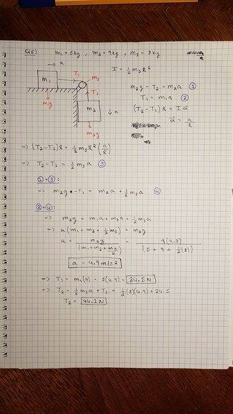

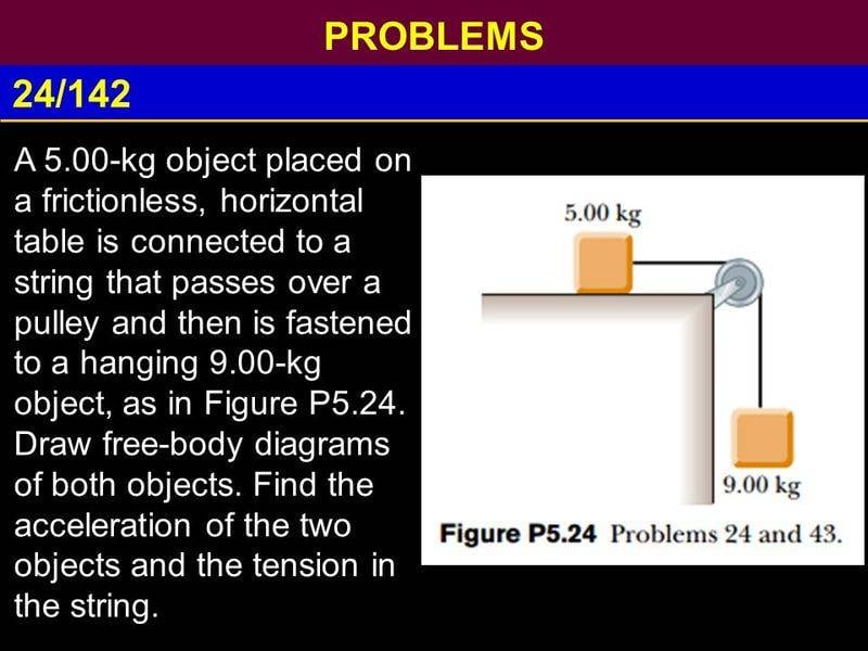

mass of pulley is 8 kg
m1a=T
m2g-T=m2a
I solved question with neglecting mass of pulley but should I?
How does the mass of the pulley affect the problem?
If you want to include the rotational inertia of the pulley, you either need to know its radius or solve for the acceleration in terms of the radius.
Is that right?
Jacobs said:
Is that right?
That is correct.
But why 1/2mr^2 instead of mr^2?Yes it is cylinder but particle moves as x and y-axis not z
Not all parts of the pulley are at distance r from the axis.
But r is radius of pulley
To find the inertia of the pulley or disk, you need to integrate r^2 dm over the dimensions of the pulley I = r^2 dm = ∫∫∫ r^2 (ρ r dr dθ dz). If you do that, you will find I = (mr^2)/2 where m = ρV = ρ π r^2 t, t = thickness of the disk.
Yes, but only its periphery is at distance r from the axis. A mass element dm on the oeriphery does have moment of inertia dm r2 about the axis. Other parts of it are closer to the axis so have a smaller moment of inertia. The average turns out to be the same as if all parts were r/√2 from the axis. Dr dr news has posted the details of that.
