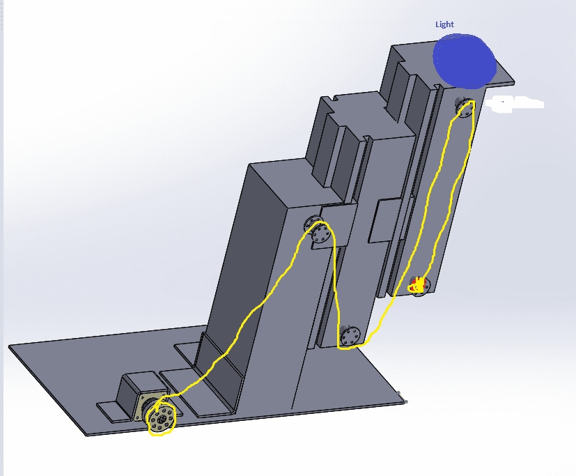

Summary:: I am designing a linear telescopic system that gets elevated with a step motor, but in order to find the compatible motor, I need to work out the torque that is required for the elevation. I have uploaded my CAD model to this thread with how cables are connected. Could someone please teach me how do I go about calculating the torque that is required? it is even more difficult with a pulley that is also moving up in the system. Thank you in advance...

The horizontal offset of the 3 stages seems like it would introduce a lot of extra stress and friction. What kind of bearings are you using between the stages? Also, the cable routing from the 2nd stage to the 3rd stage looks to be wrong to me.
Is this for a schoolwork project?
Yh it is a schoolwork project Berkeman, those three stages are linear sliders. I got this idea from this video .

And in the video, it's important to notice that they are trying to keep the vertical telescoping mechanism co-axial to minimize bending stress friction. And note how the cable is routed -- it is different from what you show in your sketch...

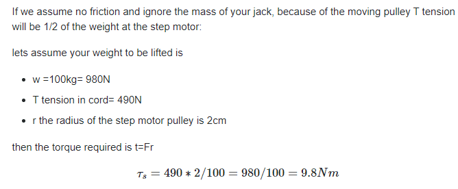

Furthemore, would I be able to use this to find the torque.
Typed text with a worked torque calculation: no friction, moving pulley tension T is half the weight, w = 100 kg = 980 N, T = 490 N, r = 2 cm, torque t = Fr, giving Ts = 490 * 2/100 = 980/100 = 9.8 Nm.

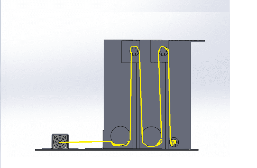

This is the sketch from the video, later in the video he replaces the pulley with a screw eye hook, I think that's is why he didn't have another hook in stage two.
CAD rendering of a mechanical frame with a routed cable path drawn in yellow over several pulleys mounted on its vertical plate and a drive pulley on the base.
Do you think this cable arrangment will cause the elevation. I still have not considered about the co-axial design to decrease the bearing friction.
Yes, when the cable is fully taut, the bottom of each stage is aligned with the top of the previous stage.

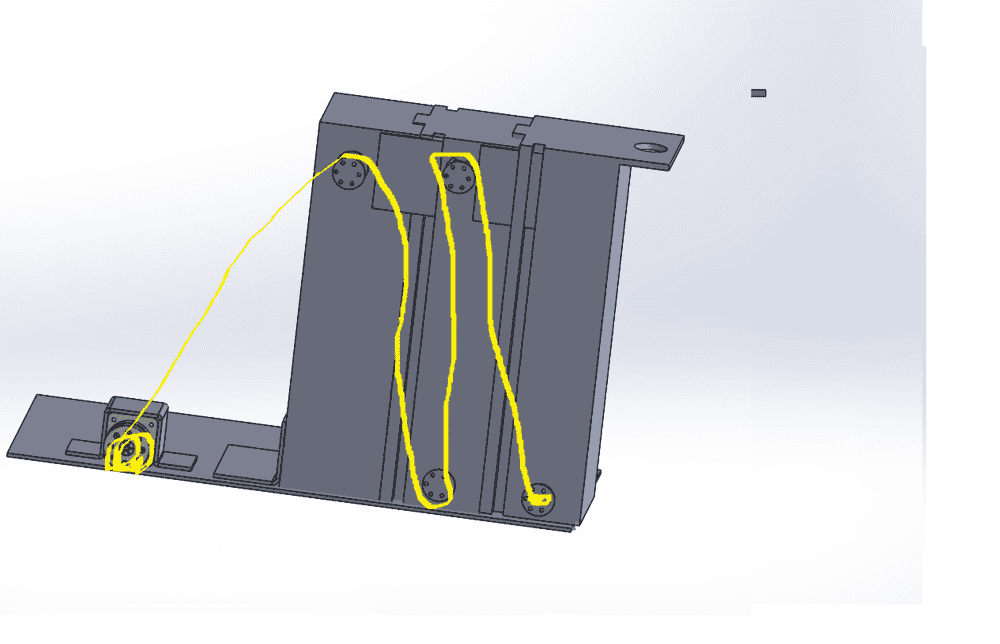

Hi Berkeman and @Lnewqban,
I have taken all your advice into account and slightly modified the design to minimise the bearing friction, I have increased the diameter of the second stage pulley and also introduced another pulley in the first stage to decrease the friction. I am learning a lot from your feedback, would you be able to evaluate this design again, please?
TBH, I'm not seeing any changes that would reduce bearing friction. Have you considered tilting the whole thing to the left some, so that the weight of each stage is carried over the CoM of the lower stage? It still won't be coaxial, but that may decrease the torque-induced bearing friction at the sliding surfaces...
