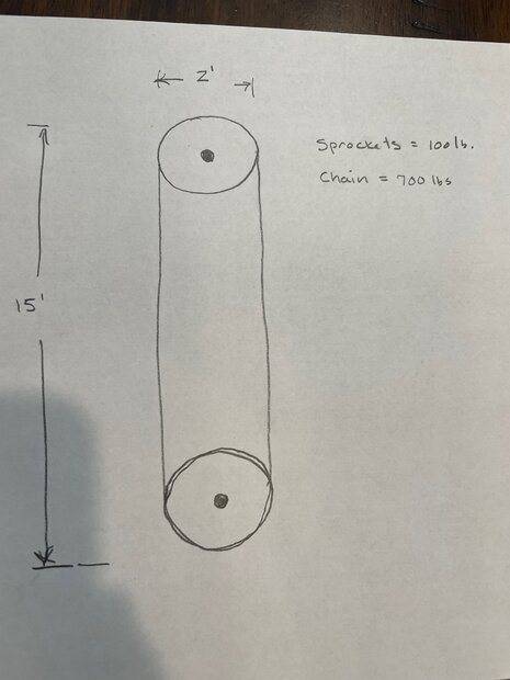

Hi,
I am trying to determine the HP motor/torque that will be required to rotate the sprocket/chain system in the image below from a resting position.
The sprockets will be at rest, rotate 5 degrees, come to a stop for 5 minutes, and then rotate again 5 degrees, repeated.
The speed of rotation is not important, but must be slow.
The motor will be attached to the top sprocket.
Thank you in advance for your help !

It will be turning pots full of liquid, equally distributed around the chain.
And the sprockets may be lighter, I am using that as a safe base.

So it sounds like you can model this as a simple turntable with weights distrubed around the circumference. The torque required will depend on the bearing friction of the system and the Moment of Inertia (MoI) of the system and the acceleration that is needed:
$$\tau = I \alpha + \tau_{friction}$$
The power (horsepower) required from the drive motor will depend on the gearing that you use between the motor and the driven system.
So let's start with your 2' radius drive gear, and assume some slow acceleration number. What is the total weight that will be moved by this system?

The total weight of the chain will be 700 lbs.
And the system is vertical. And no it will be rotating full buckets (it will load them one at a time so initially the weight will be small, and then once loaded it will rotate for 30 days as described below.

An engineering design problem such as this is done in a series of steps, generally with some iteration in the process. The following is one possible approach:
1) Calculate the maximum load on the top sprocket. Weight of chain, all buckets full, plus estimated chain pretension.
2) Calculate maximum torque on the drive sprocket. Assume that all buckets on one side of the centerline are full, and all buckets on the other side are empty. This is a worst case calculation, not a realistic case calculation. Then add in estimated friction for the nondrive sprocket, plus chain friction. If in doubt, add 50% or so.
3) Calculate RPM. You stated 5 degrees per 15 seconds, so 20 degrees per minute, which equals 0.055 RPM.
4) Calculate a gear ratio. A standard induction motor runs 1800 RPM, the load runs 0.055 RPM, so the initial try gear ratio is 1800 / 0.055 = 32,400:1.

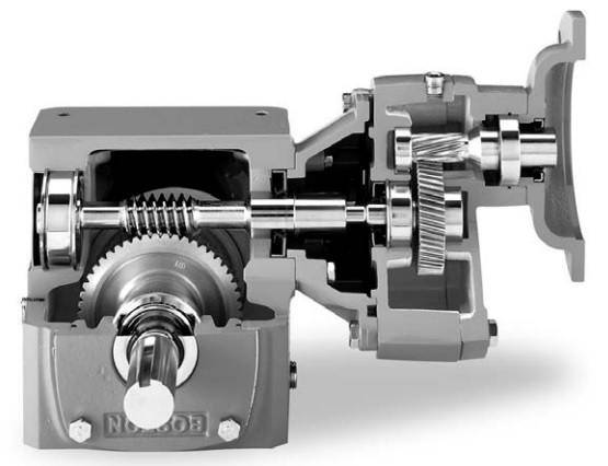

7) Now you can choose a drive motor and VFD for that motor. A simple low speed system such as this can be driven by a standard induction motor. No need for acceleration calculations, just turn the motor on and off to operate it.
8) The reducer will almost certainly be a double reduction worm gear. It will be self locking, so turning off the motor will stop it from moving. Cutaway view of a double reduction helical / worm gear reducer is shown below. The motor is fastened to the flange on the upper right, the output shaft is lower left in front:
