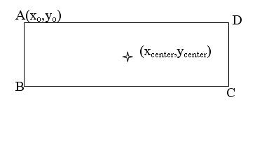

I am hoping to find the coordiantes of all 4 vertices when the rectangle is in any orientaion knowing the length l, the width b, the coordinate of its center mark (xcen,ycen), and the coordinate of vertex A as shown below:
This is NOT HOMEWORK so although I think it is possible to do, I am not sure that it is.
Diagram of an axis-aligned rectangle with corners labelled A(xo, yo) top left, D top right, B bottom left and C bottom right, and a star marking the centre at (xcenter, ycenter).
Any ideas?

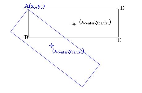

EDIT: Here is a drawing that better illustrates what I am thinking. The Blue Rectangle is the one I want to to find the vertices for. I know all information in blue.
The Black Rectangle shares the same A vertex and is in what I have DEFINED to be standard reference position (SRP).
I could find the angle of the vector that points from A to the center rc of the black rectangle and compare it with the angle of that of the blue rectangle r'c
I know that the difference [itex]\theta - \theta '[/itex] should be the angle that all vertices should carve out. I just can't see how to make the actual calculations of their cartesian coordinates?

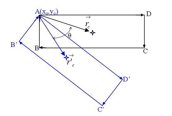

Okay :smile: Here is where I am at: Updated Diagram for reference:
Diagram of a rectangle ABCD with vertex A at (x0, y0) and a rotated copy A'B'C'D' in blue, with vectors r_c and r'_c from A to the centers, and angle theta marked between them.
rc and r'c are the vectors from A to the centers.
In order for all vertices to get from the standard ref posotion to the new positions, they must all rotate through the angle phi correct?
If A=A' is locate at the point (x0, y0), then we have the points
A(x0, y0)
B(x0, (y0+b)) *Taking down as +Y and Right as +X
C((x0+L), (y0+b))
D((x0+L), y0)
Now to use a Rotation Matrix to get the new coordinates of A' B' C' D'
I am a little confused.
Do I use the coordinates? Or the vector components of rBA,
rAD, etc... ?
FOR EXAMPLE: If I am looking at the vectors rBA and r'BA
And I know that to get from rBA to r'BA I rotated through the angle Phi. How do I get the new coordiantes of B out of the deal? :confused:

While this can be done using rotations, I don't think it's necessary.
We know that B is a distance b from A, and a distance rc from the center. In other words, it's at the intersection of two circles. You'd just need to set up the equations and solve them.
One problem I see, which is that there are two solutions for the location of B. You'll need another condition or some way to specify which solution is the desired one.
