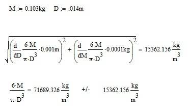

Calculate the density p and its uncertainty [tex]\Delta[/tex]p showing all working

I have tried to use [tex]p= \frac{6M}{\Pi{D}^3}[/tex] but i don't think this is the equation to get the answer.
To find [tex]\Delta{p}[/tex], I don't understand how i can find [tex]\Delta{p}[/tex] if i do not have [tex]\Delta{m}[/tex] and [tex]\Delta{D}[/tex](which i don't understand how to get) from the equation:
[tex]\frac{\Delta{p}}{p}=\frac{\Delta{m}}{m}+\frac{\Delta{D}}{D}[/tex]

You are indeed in a pickle. I've never seen an uncertainty analysis like this.
Do you know the resolution of the measuring devices? The resolution is the "smallest marking
" on your measuring device. For example: Most rulers have 1/16th of an inch as the smallest mark, therefore the resolution would be 1/16th of an inch.
Once you know that, you should be able to preform a uncertainty analysis using the Kline and McClintock method.
An example can be found http://lyle.smu.edu/me/2142/uncert/uncert.htm"
I feel like this will not answer your question because I've never seen a uncertainty method like this.
Taking a compete stab in the dark, and making quite a few assumptions.
I assume that since kg is measured to .0103, that these are all significant digits and that the resolution is .0001 kg. Therefore, the zeroth-order uncertainty is .0001/2 kg = .00005kg.
Similarly for the diameter. .014, all significant. The uncertainty1 is .001 m. The Zeroth-Order uncertainty is .001m/2=.0005m
See Attachment
