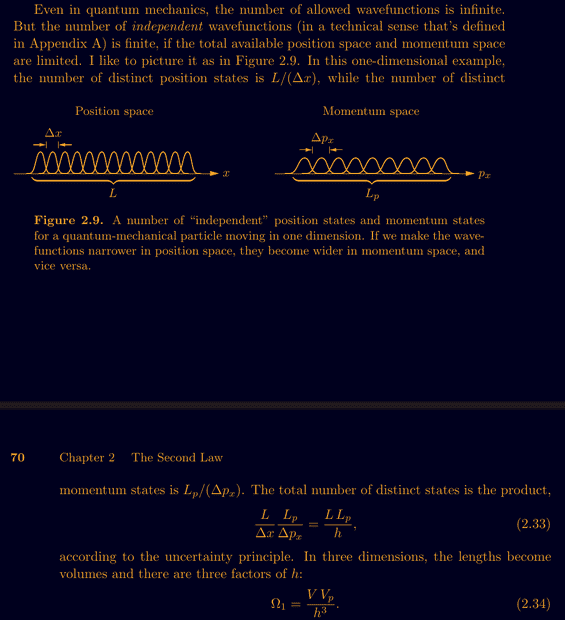

In *An Introduction to Thermal Physics* by Schroeder, while deriving the multiplicity of an ideal gas makes the following statements (image below):
Even in quantum mechanics, the number of allowed wavefunctions is infinite.
But the number of independent wavefunctions (in a technical sense that’s defined
in Appendix A) is finite, if the total available position space and momentum space
are limited. I like to picture it as in Figure 2.9. In this one-dimensional example,
the number of distinct position states is L/Δ x, while the number of distinct momentum states is L_p /Δp_x The total number of distinct states is the product,
$$\frac{L\,L_p}{\Delta x\,\Delta p_x}=\frac{L\,L_p}{h}$$
according to the uncertainty principle. In three dimensions, the lengths become
volumes and there are three factors of h:
$$\Omega=\frac{V\,V_p}{h^3}$$
Here we have an ideal monoatomic gas's single atom in a cuboidal box, whose momentum is constrained in the following manner
$$p^2_x+p^2_y+p^2_z=2mU$$
Where m is its mass and U is its kinetic energy.
Since this is the equation of a sphere, we can multiply by a small thickness Δp_r to make it a volume.
Now the calculation for the momentum volume in Schroeder seems off to me, in that the volume here is a sphere rather than a cubical box, thus instead of using $\Delta p_x,\Delta p_y,\Delta p_y$, shouldn't $\Delta p_r,\Delta p_\theta,\Delta p_\phi$ (uncertainties in spherical coordinates) be used? this would alter the uncertainty products as well, making the overall constants a bit different.
Phase space cell of volme h is like a piece of Lego block any shapes of which are allowed keeping volume h. I do not share your concern because I think any figure in phase space can be constructed by the cells , like sphere is made of square Lego blocks.

Ah so you are saying that the V_p can be sliced into multiple L_px, L_py and L_pz, we divide each by Delta x, y,z and then add up all of them to make a sphere?

Roughly yes, but be careful that I said about phase space. Coordinate space cell has voume of dimension L^3N. Momentum cell space has volunme of dimension (MLT^-1)^3N. Phase space cell has volume of h^3N whose dimension is (ML^2T^-1)^3N. Here N is number of particle in the system.

Yeah i understand that, but not in relation to what you said. Are you saying that dimensions of physical space and momentum space aren't same? if yes, then yeah i get that. but are you saying anything else in addition to it?
I just note that momentum cell has coordinate cell as its counterpart so that their volume product is h^3 for one particle case. In this context phase space which combine coordinate space and momentum space is convenient to describe the states.
