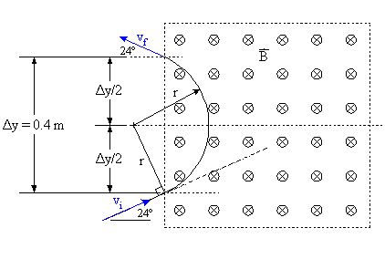

So there's a rectangular region in the xy plane subjected to a magnetic field B with strength 0.06T pointing in the -z. A proton moving in the xy plane enters the region with velocity v such that the velocity components are initially vx = v*cos(24), vy = v*sin(24). It leaves the rectangular region at a point 0.4m above (as in yf = yi + 0.4m, xf = xi) its entry with the same vy and opposite vx. What is v?
F = qv x B, qvB = mv^2/r
I figured I could just use F = qb x B to find the force in the y direction and then divided by the mass and integrated twice and set it equal to 0.4m, then solve for v, like
F/m = a = qvBcos(∅)/m
so=
x = 0.4 = ∫∫vqBcos(∅)/m d∅^2 + ∫vsin(θ)d∅ for ∅ = 24 to 154
then solve for v. The first integration is due to the B field and the second is just integrating the initial vy.
But I'm off by more than a couple orders of magnitude...
Any help would be appreciated! I suspect that my way isn't the easiest way, but if anyone could explain the flaw in my approach anyway that would be awesome.
Thanks for the help!
I think you can put away the heavy machinery if you draw the trajectory of the proton through the region and see if you can't locate the center of curvature (i.e., find the radius of curvature).

Once again I offer the suggestion that if you can determine the radius of curvature of the proton's trajectory while it is within the region of the magnetic field then you can determine the velocity of the proton without a lot of mathematical strife.
You are essentially told that the entry angle and exit angle are mirrored; on exit the horizontal velocity is the negative of that on entry, and the vertical velocity is the same as on entry. Further, you are given the separation of the entry and exit. You also know (or should know!) that the trajectory of a charged particle while in a magnetic field perpendicular to the plane of the motion must be circular in nature. Determining the radius of that circle is equivalent to determining the velocity (see the OP's Relevant Equations).
So I offer up the following diagram for consideration:

Thank you very much for your responses gneill. I really do appreciate them, and I can see that they present a simpler approach to a solution.
I am still frustrated by my lack of understanding as to why my original approach didn't work. Something I'm trying to work on is my calculus skills (a great and unfortunate weakness of mine is in setting up problems appropriately using calculus) so even though your solution is both simpler and more elegant, I remain extremely curious where the problem in my original approach lay. Sorry that I did not express my gratitude for your thoughtful responses earlier.

You assumed that force acts only in the y direction. It is not true. The force is F=q[VxB], cross product of vectors V and B, and is perpendicular both to V and B. At the first instant, the force acts really in the y direction, and the particle accelerates and gains velocity in that direction. In the next instant, the direction of the velocity has both x and y component, and so is the acceleration. ax=(q/m)VyBz, and ay=-(q/m)VxBz.
You have to integrate the acceleration with respect time to get the velocity, and have to integrate velocity with respect time, to get displacement. You tried to integrate with respect theta. That was wrong.
