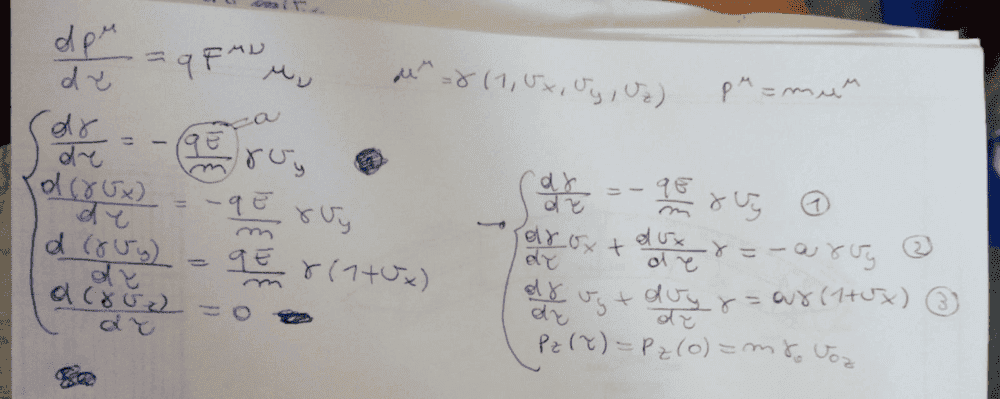

Find the four-momentum of a charged particle in an external, constant electric and magnetic field.
dpμ/dτ=q*Fμν*uν
pμ=muμ
I have to find pμ(τ) of a particle of mass m and charge q with v(0) = (vx(0), vy(0), vz(0)) in a electric field E parallel to the y-axis and a magnetic field B parallel to z axis, both constant and uniform, with E = B.
Here follows what I have done (see pictures below):
I wrote 4 differential equations (using that E=B) and called qE/m = a. The last equation (z axis) is immediately solved.
246552

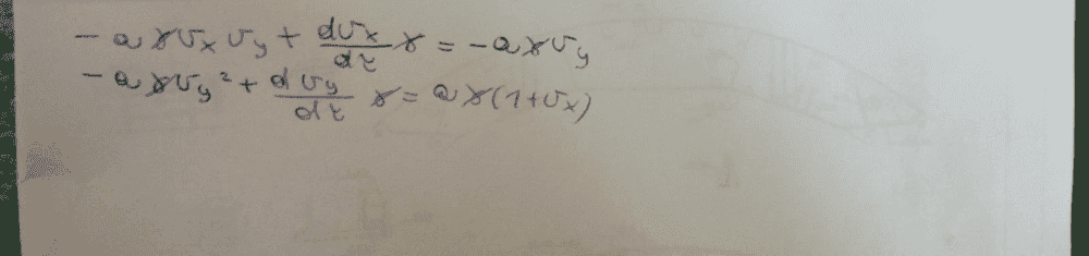

To solve the others, I substituted equation (1) in (2) and (3), obtaining this:
246553
... but I don't know how to solve these. How do I find the x and y components of the four momentum?

ful disclosure i have seen this method online and not something i came up with myself
\frac{d P^{\mu}}{d \tau} = q F^{\mu \beta}u_{\beta}\\
i think ##F^{\mu \beta}## looks like this
\begin{pmatrix}
0&0&E&0\\
0&0&B&0\\
-E&-B&0&0\\
0&0&0&0
\end{pmatrix}
m\frac{d^2 u^{\mu}}{d \tau^2} = q F^{\mu \beta} \frac{d u_{\beta}}{d \tau}\\
m\frac{d^2 u^{\mu}}{d \tau^2} = \frac{q}{m} F^{\mu \beta} \frac{d P_{\beta}}{d \tau}\\
m\frac{d^2 u^{\mu}}{d \tau^2} = \frac{q^2}{m} F^{\mu \beta} F_{\beta \alpha}u^{\alpha}\\
F^{\mu \beta} F_{\beta \alpha} =
\begin{pmatrix}
E^2&-EB&E&0\\
-EB&-B^2&B&0\\
0&0&E^2-B^2&0\\
0&0&0&0
\end{pmatrix}
this has uncoupled the ##u^y## equation and since##E^2 - B^2 = 0## it is quite easy to solve for it and then you plug ##u^y## into earlier equations to get other components
someone tell me if it is wrong

Looks like there are some "typos" here. We can let @Giuops find them if he/she wants to. :oldsmile:
This way of uncoupling the equations is pretty nifty.
oh i think i see them i think forgot to change some values after copying the first matrix
