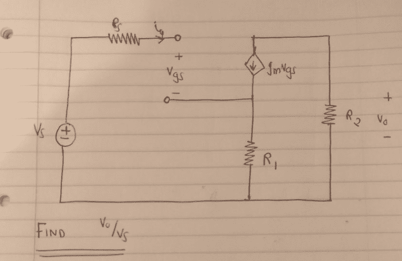

Hand-drawn circuit schematic on lined paper: source Vs with series resistor Rs and a current ig, controlled current source gm·vgs in parallel with R1 and R2, output voltage Vo across R2, with the prompt FIND Vo/Vs.

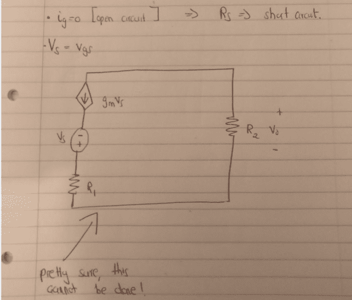

I can't seem to figure out the answer. Apparently, the right method involves saying that Vs is actually equal to the voltage Vgs + voltage across R1. I don't understand how Vs could be voltage across R1?
This is what I have so far
Handwritten small-signal circuit sketch: a dependent current source gm Vs in series with a source Vs and R1 on the left, joined to R2 on the right, with output Vo marked across R2; notes read ig=0 [open circuit] so Rs is a short circuit, and Vs = Vgs, with the comment pretty sure this cannot be done.
I think the first two bullet points that I wrote are correct but 99% sure that the circuit transformation I did is completely wrong.

I wouldn't call Rs a short circuit just because there is no current through it!
Vs = voltage across Rs + Vgs + voltage across R1
because these voltages are in series between the point where the potential is Vs and the point where the potential is zero volts (ground)

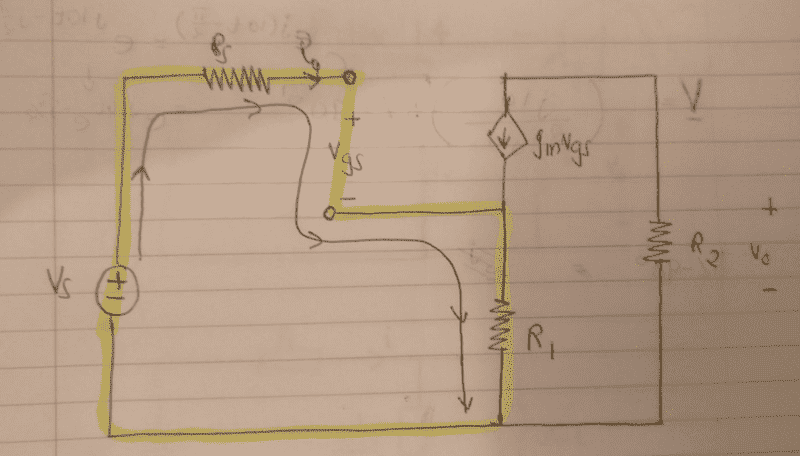

Oh. I see. So you're sort of looking at it like this. And that's how u found out what Vs breaks down into
Hand-drawn circuit schematic with a voltage source Vs, resistors Rs, R1 and R2, a dependent current source gm Vgs, and labeled voltages Vgs and Vo; a loop path is highlighted in yellow.
Arrow doesn't mean current.

Yes. For every path traced between 2 nominated points, the total potential will be equal.

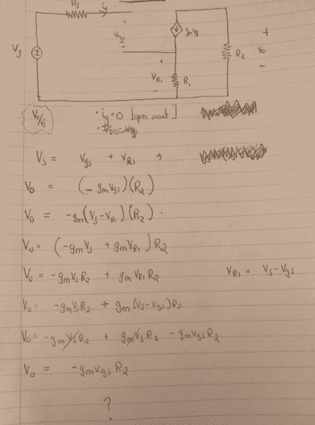

I take that statement back. I'm stil stuck :(
Handwritten derivation of voltage gain Vo/Vs for a small-signal circuit with a dependent current source gm·Vs2, resistors R1 and R2, and a series of equations ending in Vo = -gm·Vgs·R2 with a question mark.
I just went in a full circle back to the equation I started with...

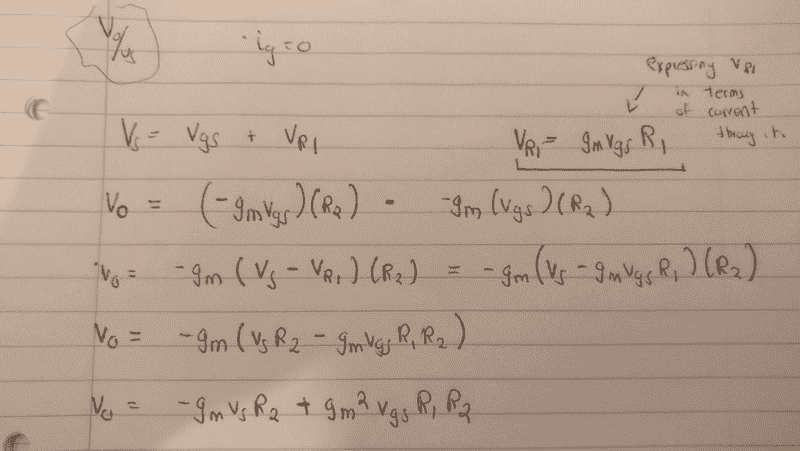

NascentOxygen said:
Express VR1 in terms of the current through it.

I suggest you go back just one step.
You have a dependent source (gmVgs) that relies on an internal voltage (vgs). you need to relate that internal voltage to component values and independent sources.
Write out the expression as Vgs =? as a function of Vs, gm, R1, and constants.
Once you get that expresion, you already stated that the output is -gmVgsR2, you should be able to solve for your transfer function Vo/Vs. You're very close
Also just a note, pay attention to this model, it will become more important as you learn more about circuitry. It is the small signal model for a type of transistor, a MOSFET
