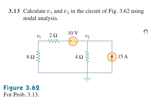

Circuit schematic for Problem 3.13 with nodes v1 and v2: an 8 ohm resistor and a 2 ohm resistor and 10 V source in series on the left branch, a 4 ohm resistor on the right, and a 15 A current source on the far right, with a ground symbol at the bottom.
KCL: Σi = 0
KVL: Σv = 0
Using KCL:
15 = (v1)/8 + (v2)/4
Using KVL:
(v1) - (v2) = (I2)R + 10 (v1) - (v2) = (I2)2 + 10
(I2) = (v1)/8
(v1) - (v2) = (2)((v1)/8) + 10 (v1) - (v2) = (v1)/4 + 10
Now there are two variables and two equations.
Solve second equation for v1. (8)(15) = v1 + 2(v2) v1 = 120 -2(v2) Plug into first equation.
120 -2(v2) -v2 = (120 -2(v2))/4 + 10
120 - 3(v2) = 30 -.5(v2) + 10
120 -2.5(v2) = 40
-2.5(v2) = -80
v2 = 32
This could then be plugged back into either of the first equations to solve for v1. However, according to the solution in the back of the textbook, v2 = 40V not 32. What have I done wrong?

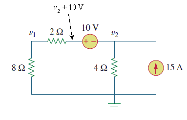

I'm not sure where your algebra has gone off track, but I will say approach for finding the circuit equations is not a standard one for nodal analysis.
In nodal analysis you take one node at a time and write equations for the sum of the currents there, setting it to zero. You don't introduce new current variables (and then eliminate them with further gyrations).
So for example, at the v1 node you would write:
##\frac{v1}{8} + \frac{v1 - (v2 + 10)}{2} = 0##
Circuit schematic with nodes v1 and v2: an 8 Ω resistor from v1 to ground, a 2 Ω resistor and a 10 V source in series between v1 and v2 (v2 + 10 V marked at the source), a 4 Ω resistor from v2 to ground, and a 15 A current source on the right.
Note that each term in the above looks like an Ohms Law calculation for the current of a branch: potential difference over resistance. If you have a node with a known current flowing into or out of it (such as is the case for the v2 node) you simply sum that in as a separate term.
Can you write the node equation for the v2 node?

How did you determine the sign for (v2 + 10)? (Why isn't it (v2 - 10)? Is it just part of nodal analysis that when a voltage source is immediately next to one of the nodes, that voltage can be added to the node voltage and treated as a single node or "supernode"? Is this how a supernode is formed?

Yup. That's that's what's behind supernodes. If you happen to have a branch with multiple voltage sources and resistances, you can sum them to yield a net voltage and net resistance for the branch.
