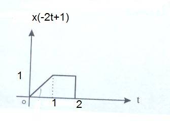

here is the x(-2t+1). i want to know how can find the x(t) diagram from this picture?

Hi baby_1, try taking it in baby steps :wink: One simple transformation at a time.
- See if you can deduce what x(-2t) would be. Hint x(-2t+1) = x(-2(t-0.5)).
- From there you can probably figure out x(2t).
- From there you can try to deduce what x(t) will look like.

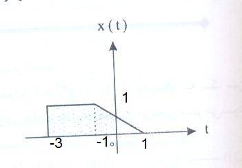

here is the answer
Graph of x(t) against t: a piecewise signal that is constant at height 1 from t = -3 to t = -1, then decreases linearly to zero at t = 1, and is zero elsewhere. Labels on the axes mark -3, -1, 1 on the t-axis and 1 on the x(t)-axis.
i want to know the step to extarct x(t) from the scaled and shifted function x(-2t+1)
Thanks
