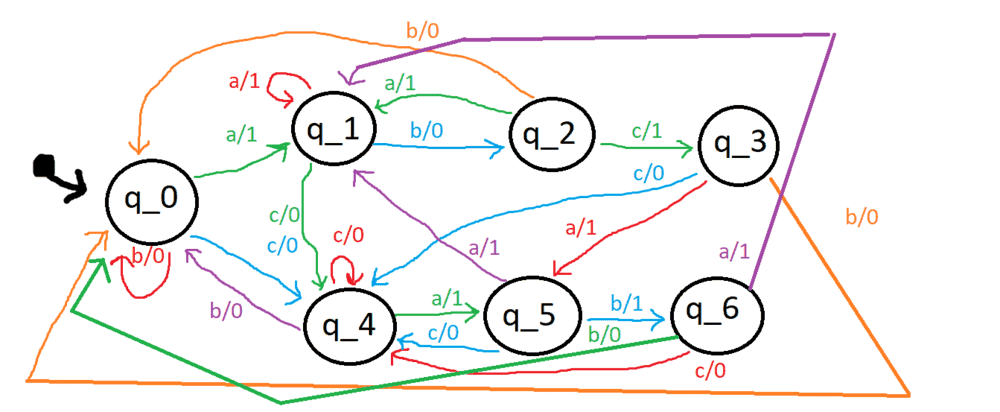

Create a finite state machine that recognizes the input strings “a”, “abc” and “cab” by
outputting a 1 (otherwise output 0 for the input).
The input alphabet is {a, b, c}. The output alphabet is {0, 1}.
The input stream may be any length, beginning with any arbitrary sequence of the input
alphabet.
The FSM should be completely specified. The FSM must include both inputs and outputs
for each transition.
The FSM should not terminate.
The FSM should recognize overlapping tokens (input strings).
An FSM is an abstract representation of behavior
exhibited by some systems.
Attached is what I have so far. I believe it is done but I am not 100% sure.
It seems to me like every case is considered. For each state, and output of a,b, or c is possible.

I like your colored state diagram, makes it much easier to follow.
I think you missed ABCABC.
You correctly found the overlapping:
A...Q1
ABC...Q1,Q2,Q3,Q5
.AB... Q6
But missed the second ABC at Q6
Also what happens if the first character is C?
There may be others, I haven't looked.
A trick I learned for complex FSMs is to create a table. There is a column for each input variable and a row for each state.
Every table location must have an entry for the Output Value when that entry is matched and the Next State to branch to. If there is an empty entry you have not completed the specification.

You are a legend Tom. I was just going through it but I don't think I would have caught that. Good eye, man. I appreciate ya!
edit: I'm not sure what you mean exactly if the first character is C. If you mean the input string starts with a c, then it goes from state q_0 to state q_4
Also, if you complete the table, that does not mean that your specification is correct, right?
edit:
Just found out there is a lot more actually.
So it does! I missed that one.
Right. You still may not have created enough states. It does encourage taking account of every possible input in every state though. When implementing an FSM in computer code, or even in dedicated hardware, table look-ups are fast and easy to change.
