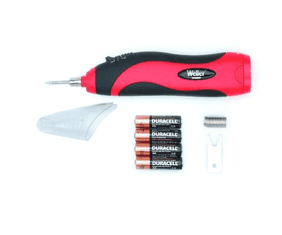

Adding to my previous response about battery-powered soldering irons ##-## a google search returns many of them in the 6w-12w range, e.g. this one from Weller Tools:

I've yet to see a battery powered soldering iron that worked well compared to the higher powered "normal" irons that plug in. Still, they have their place, like if you have to solder just a few small things in the wilderness. If you want this because it's convenient in your lab, then you are way off the mark. I can pretty much guarantee that you are also skipping other important steps. Plus there are some things that you just can't do with low power heat.
