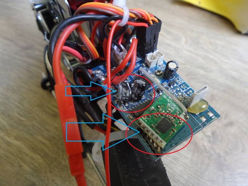

The truth is that the board didn't work even before any soldering attempt (I tested it last night and it didn't work either). So, what I have done has nothing to do with the problem. I put a new capacitor in place (I didn't solder it just put it there) and it doesn't work now.
In some cases, the advice is "If it is not broken, don't fix it."
Other members suggested I should replace the capacitors because they will fail sooner or later and if they fail, the cost of a repair after crash would be much higher.
That contradicts what you said in post #1 (unless the whole board is unnecessary for flight.)
karabiner98k said:
Despite the damages, the board works perfectly fine and there is no visible change in helicopter flight behavior. It flies without any problems.
Anyhow, I'm sorry it's not working for you. Good luck.
No, there is no contradiction.
1 - It worked after crash (despite the damages)
2 - Some days after that it didn't work
3 - My brother tried to desolder it but failed
4 - I tried to desolder it but succeeded and removed one of the capacitors and put a new one in its place (just put it without soldering) and it doesn't work now
This is the whole story.
Looking at your photos it seems you made a good job of removing the capacitor. I don't see any sign of damage to the tracks & pads, overheating nor collateral damage to other components. The only thing you might do, is to clean up any spikes of solder round the pads - probably just remelt them and they'll shrink back to the pads - particularly the positive lead.
It's a bit worrying that the binding doesn't work, as I think these capacitors are associated with the power to the motors, rather than the receiver. Look carefully to check that you haven't dropped a bit of solder on another part of the circuit and that you haven't broken or dislodged any connectors. Check that the small board with six pins connecting it to the main board is still ok and you haven't broken or dislodged any of its connecting pins.
Having got as far as you have (I think you've got the replacement capacitors), you may as well finish removing the other capacitor and solder the new capacitors in place. If it still doesn't work, you haven't incurred further cost, other than your time & effort, but you will have gained a bit more practice soldering! I can only hope that the unsoldered connection was not good enough, or the other capacitor has now failed and may be (partially?) shorting the power supply.

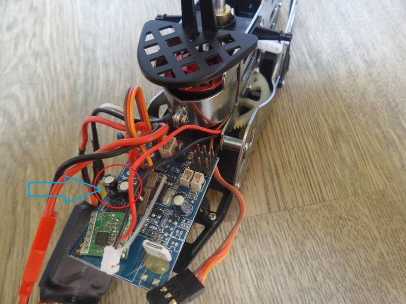

The small board had been damaged and when I wanted to straighten it, it came off the main board!
I know it may be impossible to reconnect it again to the main board but I will find someone to do it.
I won't fly with this board again but I will repair it and keep it as a spare part.

Hello everyone,
I have a RC helicopter that crashed recently and its receiver board was damaged.
Two capacitors were dented (as you can see in the picture) and the antenna base moved a bit.
I straightened the capacitors which can be seen in the second picture.
After crash:
After my adjustments:
But the question I want to ask is that:
Is it OK to continue flying with this board and those capacitors?
I'm not an electronic expert, that's why I need your help.
Thanks in advance.
Your answer is: "indeterminate". How do you propose a picture is going to demonstrate internal damage of significant levels? The effects of a failed capacitor has different results depending on what section of the circuit it is in. If you want an answer more precise give us a schematic and show on that schematic which capacitors were damaged.
