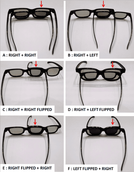

It does a good job of explaining circular polarization. But what I didn't find is a good animation or picture explaining what happens with the waves when multiple circularly polarizing filters are stacked. This would be interesting for these 6 cases (here with "reaL D 3D" glasses):
Note that:
- Most light comes through with same handedness and 180° flip (C), more than without the 180° flip (A).
- Blocking depends on the stacking order : See D vs. F and this video comparing the effect of 90° in F vs D:
https://www.youtube.com/watch?v=nVD9JA0hk_E
C vs. E is similar: Only C blocks when rotated by 90° while E is always clear.
Without a known polarizer, we cannot determine the full orientation of the elements in the glasses, but here is a possible arrangement:
left eye:
* quarter-wave plate "left-handed circular (I will call this LC) -> vertical (V)" (and right-handed circular (RC) -> horizontal (H)"
* vertical polarizer
=> LC goes through, RC is blocked
right eye:
* quarter-wave plate LC->H, RC->V
* horizontal polarizer
=> LC is blocked, RC goes through
Let's look at unpolarized light in setup A:
- 50% RC -> gets blocked at the first glass
- 50% LC -> goes through the first glass, afterwards it is V polarized. At the second glass, the quarter-wave plate converts V to RC (? should be checked), the V polarizer let's half of that through => in total 25% intensity
Now the first element is a V polarizer, it let's 50% through (which is V polarized now). The following quarter-wave plate converts this to RC, and the following quarter-wave plate converts it back to V. The last element is the V polarizer, nothing happens. 50% of the light gets through.
All other setups can be analyzed in the same way, if you know how linear polarizers and quarter-wave plates work.

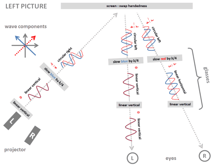

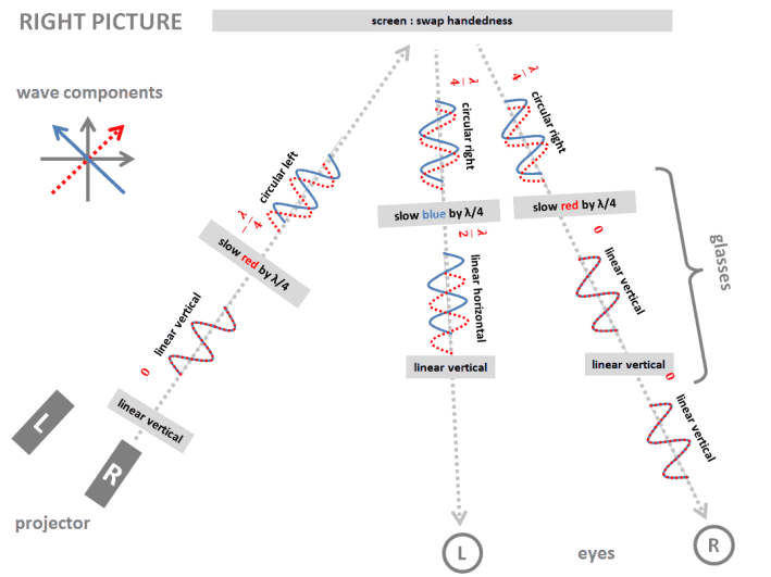

I did a diagram on the 3D cinema. Is that correct, or one valid way to do it?:
Nice image, looks good!

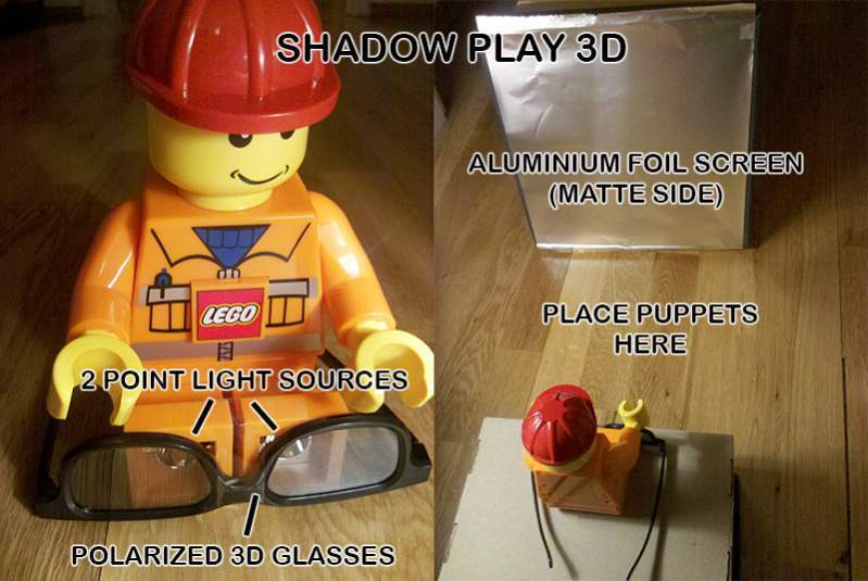

Thanks. Here is an idea I had, for a demonstration for kids . It works quite well. Obviously you need to wear a second pair of glasses to see the effect.
