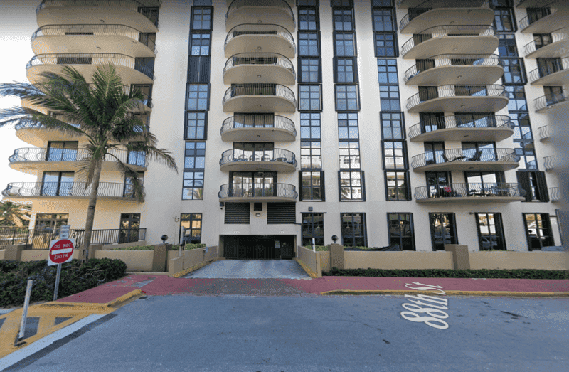

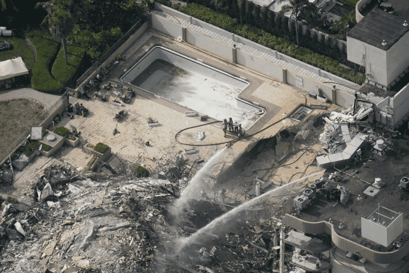

I heard a similar story. The area near the pool should be one of the least stressed/loaded areas. Also the garage floor to the west of the pool area collapsed, but it's not clear if it collapsed first or got hit by the building as it collapsed.
Furthermore, the section of the tower structure to the west of the pool is still standing, whereas the part that collapse was further away and diagonally opposite the corner with the pool. The central portion of the wing north of the pool collapsed, then the part at the eastern end, directly north of the pool collapsed (it seemed to get pulled down by the collapsed section). It may mean the ground became unstable, as in a sinkhole situation, or perhaps liquefaction. If that is the case, then all the high rise buildings are at risk, regardless of the concrete and reinforcement.

The town/city or whatever responsible entity will now have to check the stability of the ground on which that building and nearby high-rises sit. If indeed, there was some kind of sinking or subsidence, then all such structures are at risk. It will depend on the loading of the foot print.
Some of the other information indicates the garage was subgrade, or subsurface, to see if it was unstable. Also, in figures J1 and J2, it's not clear which entrance; there are two, one of 88th Street on the north side of the building and one near the southwest corner, which may be to the upper garage deck. I'm guessing from the slope, J2 is looking north up the ramp to 88th St.
Could street runoff travel down that ramp and pool in the garage? Could the water/rain and upper garage deck pool and drain to the lower garage level? If the waterproofing failed, the water could seep into the foundation and subsurface, where drainage may be poor, given that it is near sea level. Then if water pooled in the subsurface, the ground could become soft (and more easily flow), AND if there is saltwater intrusion into that formation, then the pooled freshwater would allow migration of the sea water into the formation, which might explain the corrosion of the rebar and concrete floor.
Inspections will have to look at the subsurface to see if there is seawater intrusion under the concrete flooring and footings of the building. Then they will probably have to rewrite the code to prohibit similar construction on the island. They should probably look for corrosion in Surfside's sewer/storm drain system.

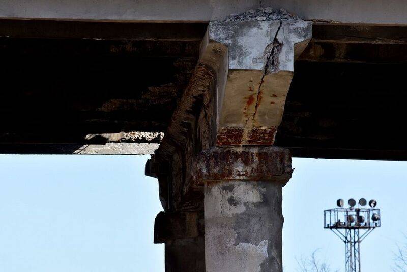

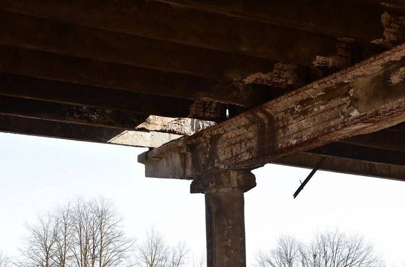

This building was "enjoying" a winter/summer climate left abandoned for some 25 years. At the moment of demolition it's total age was close to 40. It was a Soviet sanatorium built in the early 80's.
It has a very interesting reinforced concrete pillar/column type base that extends up to around the 3rd floor. On those columns sits the whole upper structure. Beneath them was built a smaller 2 story building.
https://www.google.com/search?q=sanatorija+liva&source=lnms&tbm=isch&sa=X&ved=2ahUKEwiQqKf27LrxAhWqlYsKHX9-A9AQ_AUoAXoECAEQAw&biw=1366&bih=615
Now what I want to illustrate with this is that even after all the columns of this building were half cut to weaken them, not to mention they were out in the open rain and frost for decades , then even after breaking half of them just the structure directly beneath fell down while the rest was left standing. This structure was also assembled from reinforced concrete panels welded together, instead of floor slabs and columns cast as a monolith on site as the Florida building.
I highly doubt the Florida building was in a worse shape than this abandoned sanatorium.
Both were roughly the same size and height. It takes an awful lot of rusting and cracking where that alone can cause a collapse like this, in a reinforced concrete monolith structure.
In the FL case, since the structure seems like a monolith cast reinforced concrete , I'd say that in order to initiate a collapse multiple adjacent columns would need to completely lose vertical loading capability, one is not enough since if only one loses such capability it then "hangs" in the floor slabs connecting it to the adjacent columns. Surely it might be the case that the adjacent columns or floor slabs were so weak that having to bear the load of just one additional column was enough but again I doubt that. My bet is on multiple columns.
What can cause that is an open question in this case.

Another "red flag" a day or two before the collapse?
From Miami Herald via Yahoo - https://news.yahoo.com/two-days-condo-collapse-pool-202849974.html
There was nothing unusual about the lobby and pool area at Champlain Towers South condo, which looked clean and well maintained to a commercial pool contractor who visited the building last Tuesday, just 36 hours before half of the building unexpectedly collapsed. Then, he saw the basement-level garage.
One has to wonder, if someone saw something alarming, then what is the responsibility to report it? Maybe it wasn't in his workscope, but geez . . . It seems the building has been deteriorating in front of everyone who went through the garage, but somehow no one thought to raise the alarm.
Mohammad Ehsani, an engineer and concrete restoration expert who invented QuakeWrap technology, a way to reinforce old concrete columns, reviewed the contractor’s photos from the pool equipment room.
“You can see extensive corrosion of the rebars at the bottom of the beam. That is very serious,” Ehsani said, commenting it was the worst damage he had seen documented in the building so far. The equipment room runs along the southern wall of the building — an area that did not collapse.
“If the condition of the beam in the pool guy’s photo is something that was also happening under the building, that is a really major concern,” Ehsani said. In that case, it “absolutely” could have contributed to the collapse.
However, he cautioned against rushing to conclude that all beams in the building showed similar levels of damage to those exposed to chemicals from the pool. The 2018 report that documented “severe” structural damage to concrete in the garage under the pool deck did not include photos of anything nearly as alarming as what the pool contractor documented, Ehsani said.
It seems that the corrosion observed recently was perhaps worse than three years ago. If that area was affected, then what other areas (columns) were affected?

Now since we are talking about rusting rebar and salt effects on the structural integrity of reinforced concrete structures I want to show an interesting example.
I live in a country with winters and long autumns and springs so we have had all kinds of weather from -30 celsius in which no one can start a diesel to +35 in summer when asphalt becomes rubber like.
In winters we use a salt-sand mix for road safety so it's also sprayed on bridges where it mixes with water and seeps through every smallest crack and seem possible.
As you can imagine this is a nightmare for the bridges structural integrity, not only is it fully open to year round weather conditions without any heating (unlike a building) it has to endure concentrated salt-water mix being poured on it for months at a time.
Here we had a local bridge that is being renovated now after some 50 years of use without any major renovation. The reason they shut the bridge down because they realized that the concrete columns and particularly the rebar within them was so rusted that the concrete was becoming split open.
See the pictures to understand the condition better
https://www.lsm.lv/galerijas/31010/augusta-deglava-parvads-riga/?idx=6
See the link for additional pictures that might make you scared.
But given the extensive structural damage this bridge had and it's 50+ year history without any repairs it still did not collapse even though it had semi truck and bus traffic over it constantly.
There are many structures in similar climatic conditions like this in a shape even worse than this and a collapse is very rare for any of them.
