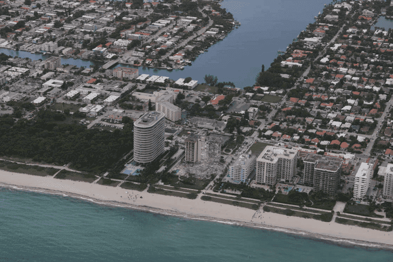

Aerial view of a coastal Miami Beach neighborhood with a partially collapsed high-rise condominium tower beside the ocean, surrounded by low houses, canals and a sandy beach.
(Copied from https://www.msn.com/en-us/news/us/collapsed-miami-condo-had-been-sinking-into-earth-as-early-as-the-1990s-researchers-say/ar-AALoUP0)
For context, the high rises are the minority in this part of Miami Beach. The other problematic subsidence spots seen in the study were under much smaller loads.

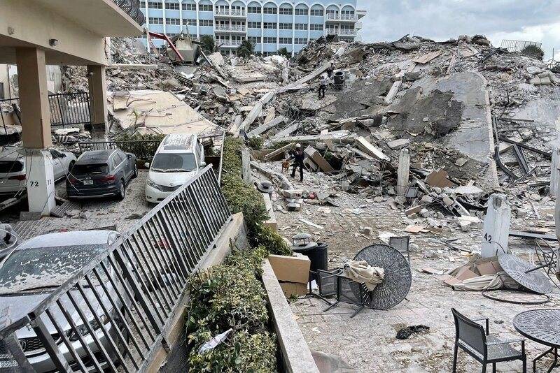

Edit/update: https://www.wsj.com/articles/miami-...ve-emergency-response-11624532492?mod=itp_wsj
I attached part of a picture from the WSJ article. The two columns to the left side look like they are damaged. It seems like rebar is splayed and protruding from the columns. The upper brown-colored portions looks like it shifted with respect to the lower white-colored portion. I think the floor of the parking garage has collapsed having separated from the columns. The rebar protruding from the columns seems to have been part of the garage floor.
  • Photo of a collapsed multi-storey building, with a large pile of concrete slabs, rubble and debris in the foreground, rescue workers among the wreckage, and parked cars and a metal railing at the left edge.
That is a very good picture.
Most I have seen are way too close to provide an accurate perspective.
We can see the twin building, erected following similar drawings and about the same time frame.
It is the third building farther North from the disaster point.
Also, the size of the next building on the South side can give us an idea of the amount of vibration (mainly due to pile driving) that its construction transferred to the decaying structure of the old building.
